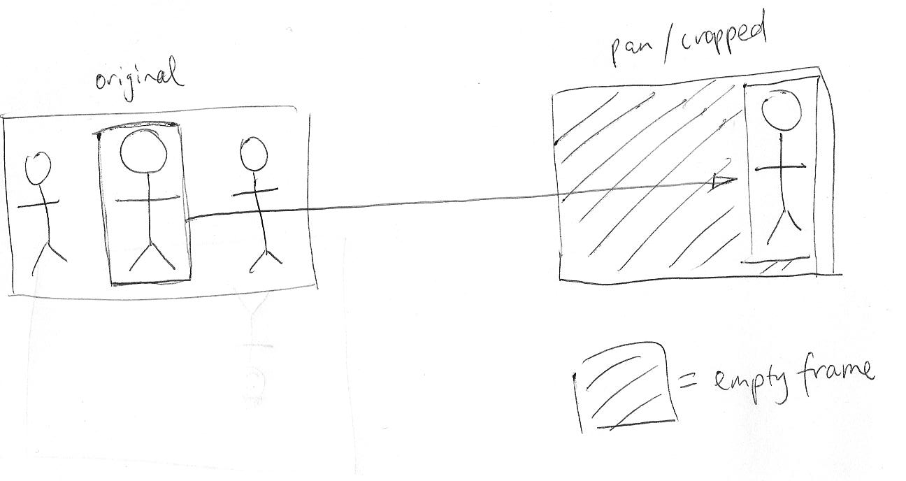

I'm editing an opening sequence for a HD feature in Vegas and am pretty new to it. I'm using lots of split screen and movement - think the start of 'The Thomas Crown Affair' (the original Steve McQueen one) or the opening of '24').
As far as i can tell the only way to achieve the pan/crop i've outilned in the attached diagram is to use a combination of Pan/Crop and Track Motion but not the Pan/Crop clip function alone. This means that I will have to make a Video Motion keyframe for every clip which is locked to the timeline therefore when i do any edits to the clip I'll have to change the keyframe position... somewhat frustrating. Is there any remedy to this aside from going back to using Premiere (which I'm used to and has a far more sensible clip motion/resize system where you resize the actual picture rather than the frame around it)?
The reason Im using Vegas is cause it seems to handle native HDV well and Ive been pretty happy with it so far for this rough cut. Maybe it just isn't really cut out for complex opening sequences (I'll be dding titles as well) and I ought to use something else?
Cheers,
Baldwin
pan/crop and track motion-vegas-pan-crop.jpg

Use Pan/Crop to crop down to just the one person. Use Track Motion to position the person as desired.

Ed, that appears to be what he's already doing. He's looking for a way to avoid using track motion because he wants to keep his keyframes on the event level instead of on the timeline.
I don't know if what Baldwin would like to do here is possible, but I personally think it should be. There are quite a few things about event pan/crop that really get on my nerves, and this is one of them.

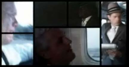

I just want to use rectangular portions of the source material and have them in different parts of the frame. I dont want to do picture-in-picture. Ive attached snapshot of the kind of thing I want to achieve.
Baldwin
pan/crop and track motion-splitscreen.jpg
Baldwin Li is offline   Reply
