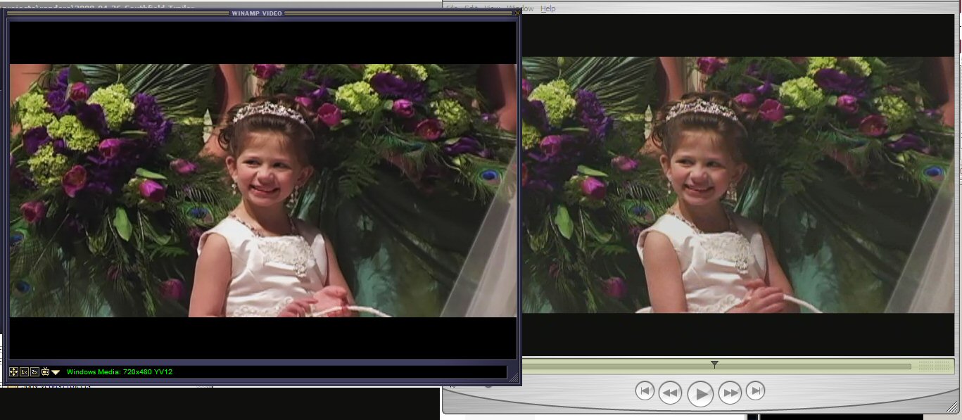

And to make things still more annoying, using the WMV rendering, a 16x9 project file with the Defatult Template (which is full size @ 720x480) and a PAR of 1.0 gives what looks like a slightly wider image, but when compared side by side with the 4x3 nested Quicktime the 4x3 nested quicktime is just as wide, but not as tall.
IN other words, it appears that the only way to get what looks like a correctly proportioned wide screen image is to nest the 16x9 project inside a 4x3 project for BOTH the WMV and MOV codecs.

And yet another addition to the perplexing MOV vs WMV rendering saga is that WMV9 default template vs Quicktime default template seems to make the MOV wash out the blacks and lost color saturation a little when compared side by side with the WMV.
