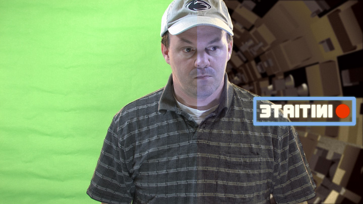

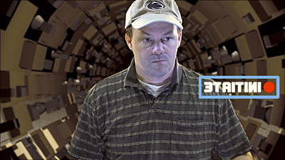

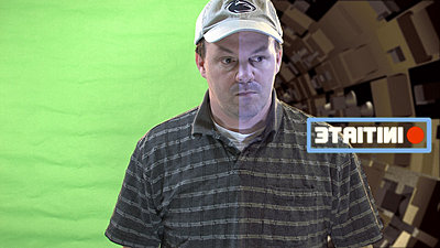

The forum was having issues, and I was not able to load these screen captures in the last post:
(Any recommendations as to where I can load some higher rez m2t clips?)
CineForm and Premiere Pro CS3 / After Effects-transpt_init.jpg   CineForm and Premiere Pro CS3 / After Effects-transpt_init_screen.jpg
