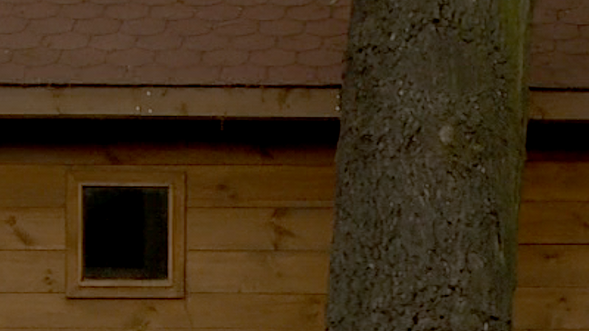

EX1 vs. nanoFlash at 50 Mbps
OK, since the wheather here has changed so that it would take some time to get identical lighting - . I have browsed my older shots, and found a couple of scenes where EX1 can be compared directly to 100 Mbps Long-GoP and 220 Mbps I-frame only from nanoFlash. I will not post all of them, as they've been taken without the test in mind so they represent different scenery, lighting, and camera settings - but I can tell you that the conclusions can be summarized as follows:
1. The higher bit rate of the nanoFlash, the more detail and grain in its picture when compared to the EX1's own encoder.
2. Generally, the above tendency is more pronounced with long-GoP than with I-frame only compression
3. When comparing some perfectly lit and exposed scenes, containing negligible noise - the difference is still visible, but this time the advantages of nano's high data rate prevail: the picture contains more detail with less mosquito noise, and comparable grain level as the EX1.
To conclude: as summarized before, the "Garbage in, Compost out" (or GiCo - the slightly modified version of the GiGo rule, copyrights with Adam Stanislav :)) rule applies. Also, it's difficult to say whether the EX1 does use some NR just before compression, or its encoder has been so designed that it also smooths out the grain a little (along with fine detail, of course).
In order to take full advantage of the nanoFlash (at 100 Mbps and above) - the picture must be perfect from the camera!
I'm posting just one pair of pictures, comparing EX1 compression (left) to that of the nanoFlash at 50 Mbps. As you can see, the difference is much less pronounced than in the 180 Mbps example, which was to be expected - as with more color resolution, 50 Mbps is just about the same compression level as the 35 Mbps of the EX1.
PS. By no means I'd like this discussion to cease - to the contrary, opinions and examples from other EX/NF combo users are welcome - as well as from CD, of course !
Noise comparison: 35/4:2:0 vs. 180/4:2:2-35-420.png   Noise comparison: 35/4:2:0 vs. 180/4:2:2-50-422.png

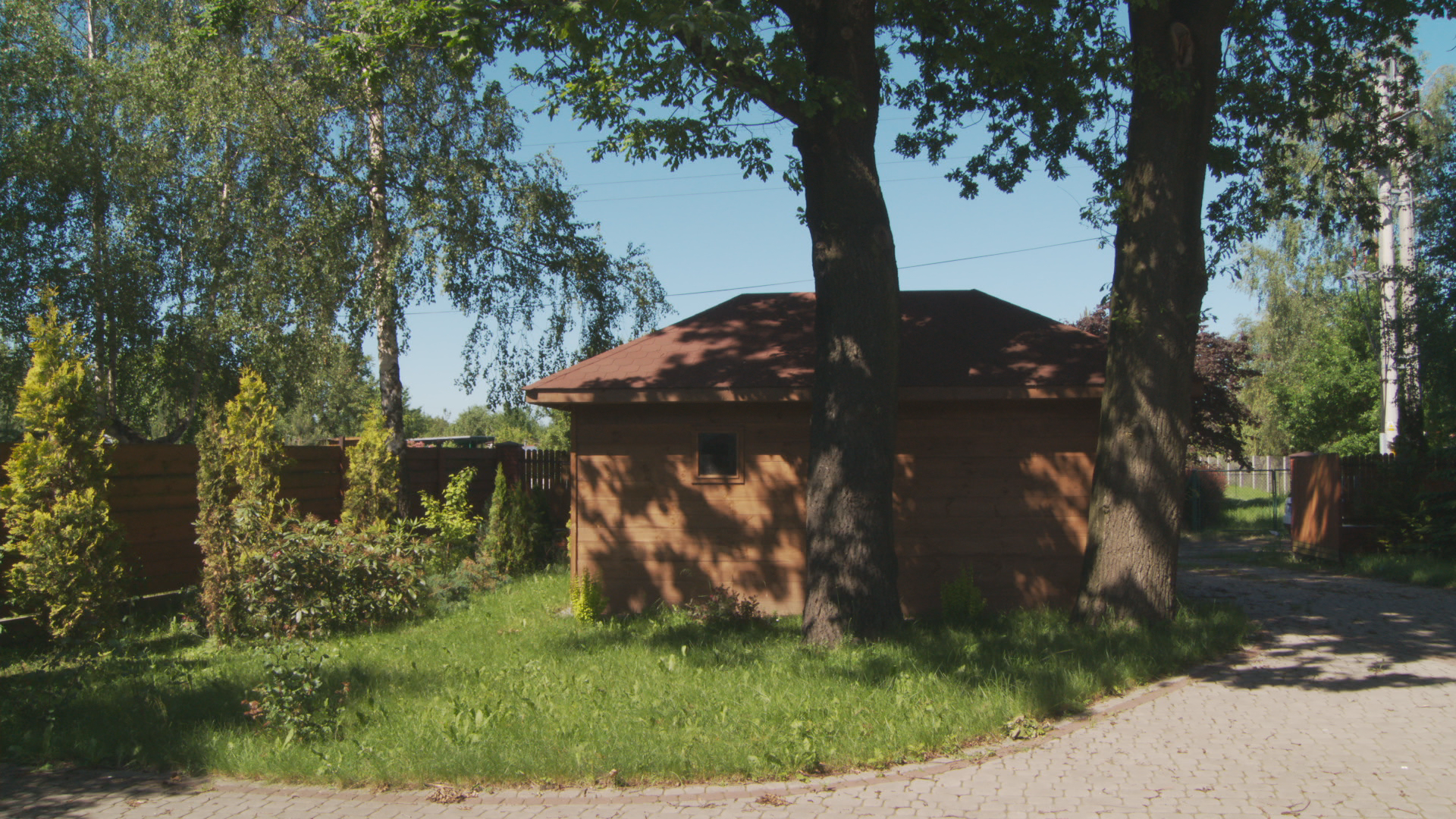

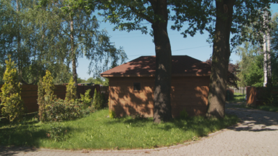

More testing, and conclusions...
OK, I've done some more tests today; quite different lighting (full sunshine) - so don't worry, I'm not going to scare you with my ugly pictures :)
However, I'd like to share with you some more conclusions on the subject (most of them may be obvious for some people, but I hope they'll be of some use to those considering buying nanoFlash, and got scared by my complaining about the noise). Important clarification: in spite of bright sunshine, I set up the testing so that areas of the same wooden barn fell into deep shadow (see the screen grab), and considerable noise was generated.
So, I tested several NF bitrates again for noise - but this time, I also played with detail settings of my EX1: I tested both 50 and 180 Mbps (NF) against the EX1 with both detail off and on, the latter with crispenig at zero (default) and +35. I was hoping that at the highest bitrate, the nanoFlash would compensate for detail loss due to detail off/positive crispening, while not suffering from the (reduced) source noise...
Unfortunately, this is not happening. Even with detail off, or with detail on and crispening at 35 - at the highest long-GoP bitrate the noise is still augmented and really distracting when watching on my 50" plasma. With 50 Mbps, it's at the same level as on SxS, with color resolution enhanced and mosquito noise reduced.
So, I'll repeat: those using the EX-series cameras in run&gun (or ENG) fashion, should stick to the 50 Mbps data rate of their nanoFlashes. The bitrates of 100 and above are for those shooting in controlled environment (or those lucky ones having cameras with higher S/N).
Well - this was the bad news (sort of). The good news (for Vegas users, like myself) is that I have tried Mike Crash's Dynamic Noise Reduction filter in Vegas, and yes - it does remove most of the 180 Mbps nanofiles' excessive grain, while retaining most of the benefits (better edge definition, color resolution, and less mosquito noise). Let's hope it'll become available for the 64bit version of Vegas soon! Of course, I'm now talking about a free noise filter; those using more advanced NLEs with more robust NR, will be even better off.
To round it up: frankly, I feel quite relaxed now that I'm more aware of the problem's nature. And limiting my nanoFlash to 50 Mbps, 4:2:2 in everyday shooting is not a bad thing, after all - at least, I'll spare some CF and HDD space.
While with the live classical music recordings I do as my "serious" projects, I hope I'll have enough light and time to optimize my EX1 settings so that I can safely use 100 Mbps on the nanoFlash, as well.
Noise comparison: 35/4:2:0 vs. 180/4:2:2-shadow.png
