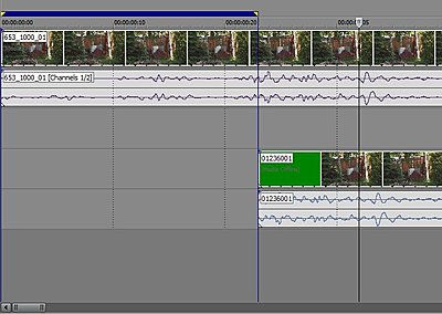

Olof,
Let us clarify: after TC alignment in Vegas, both clips' video is perfectly synchronized with a single frame precision and TC matched exactly. BUT:
I just aligned other 2 clips by TC, and now the nanoFlash clip (100/L-GoP) starts 23 frames later than its EX1 "original", and its audio is still 1 frame behind (i.e. lags by 24 frames behind the original - take a close look a the waveform peaks, e.g. right to where I placed the cursor).

Dear Piotr,
Just as a camera with a tape deck, it takes time to start recording.
Your EX camera may also take time to start recording. I do not know if this is true or not, but you could test it by recording a clock with a sweep second hand.
When starting the nanoFlash via incrementing timecode, it takes us time to start recording.
It does appear, that in 1.5.126, the audio is off by one frame.
It is not appropriate to say that we our audio is out of sync by 24 frames.

Dan - I said it's natural to me.
It does appear, that in 1.5.126, the audio is off by one frame..
Am I to understand you confirm this officially? So, it's not just my unit - right?
I never said this - I only explained to Olof that while the NF video can lag as long as 23 frames behind the camera source, the audio seems to still be one more frame behind the video...
