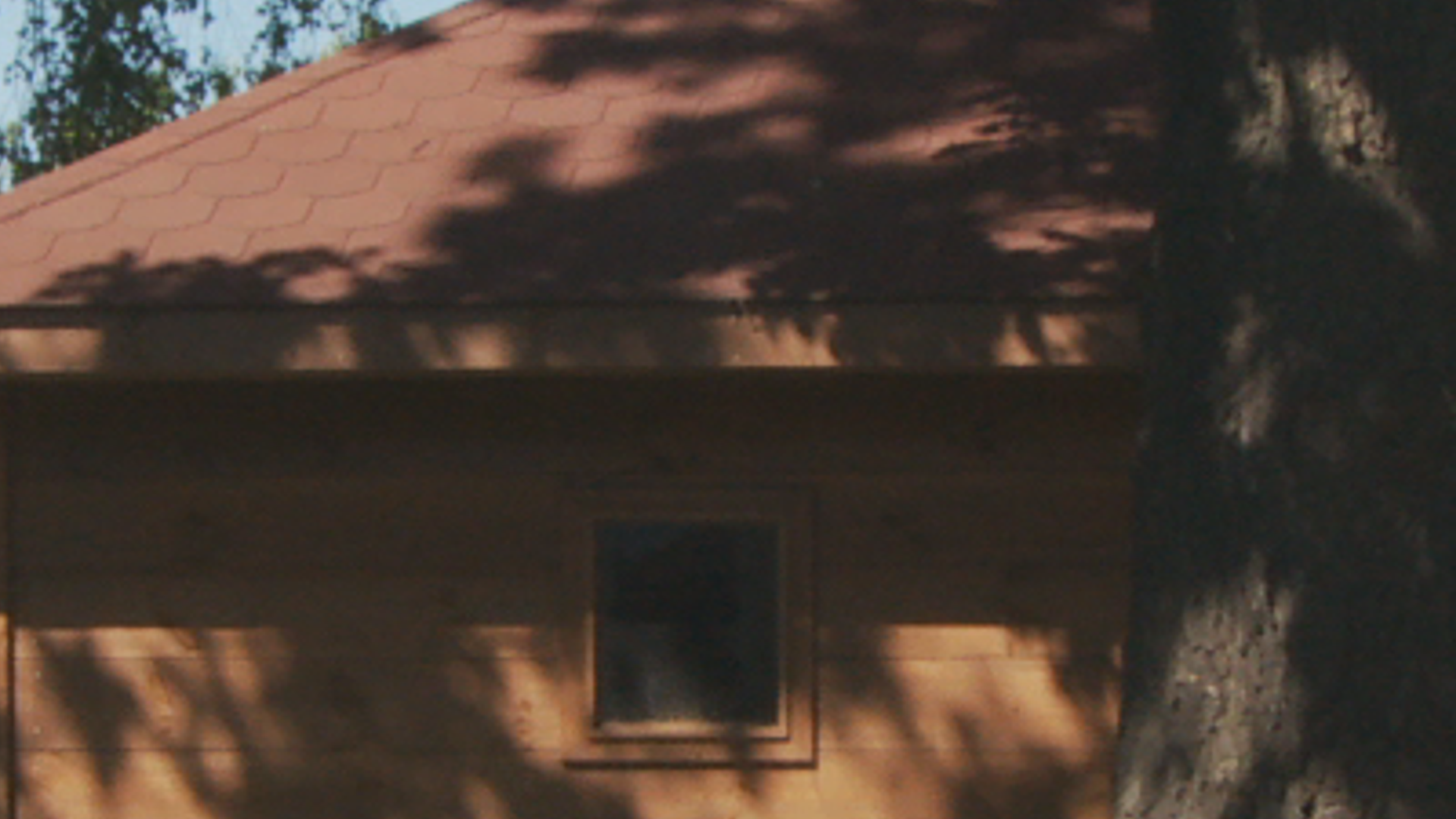

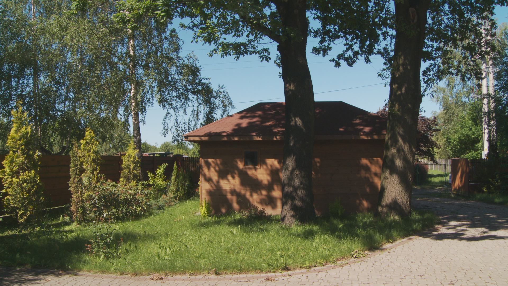

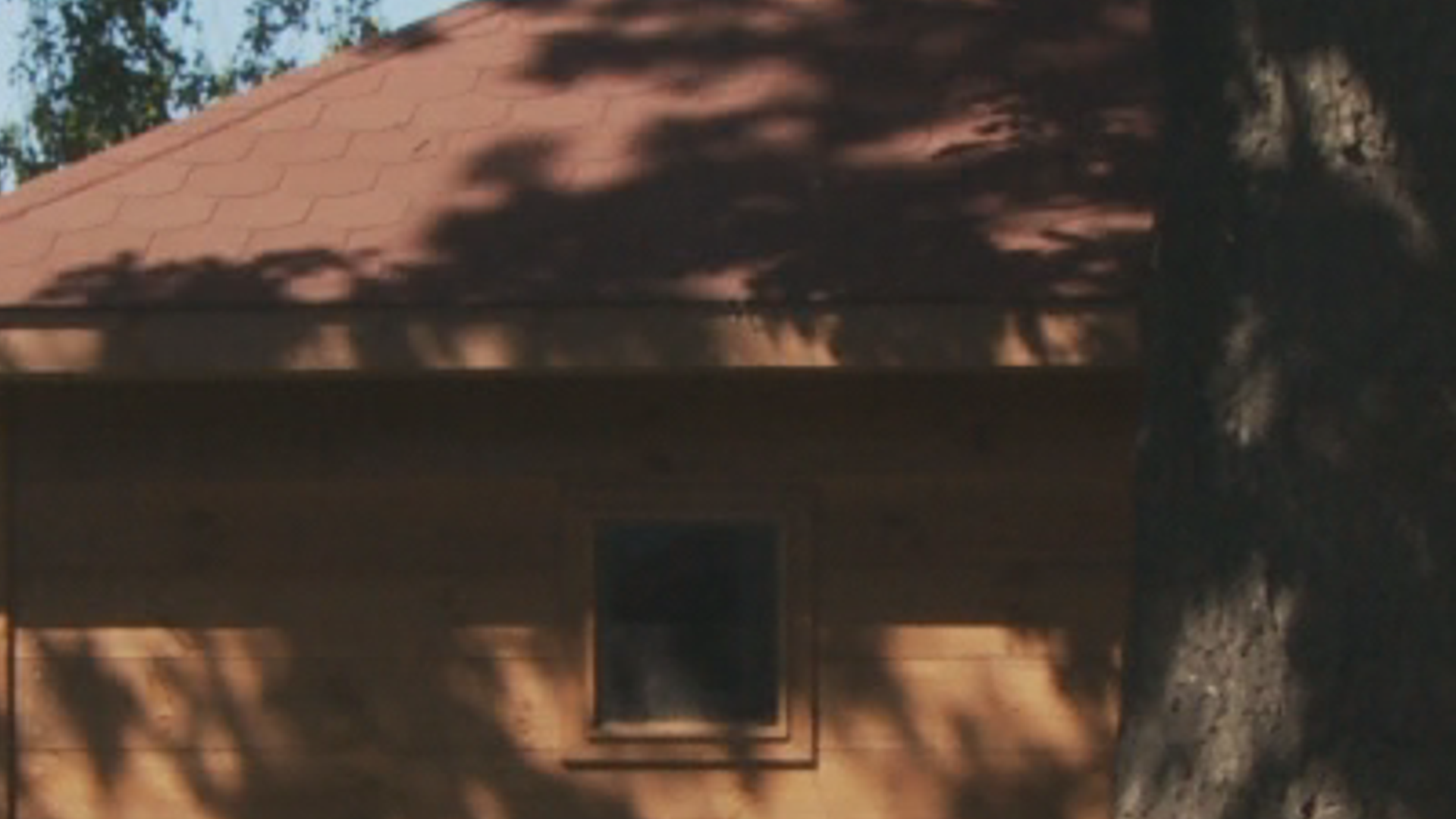

Originally Posted by Peter Moretti View Post
What you say directly above makes perfect sense to me. But further up you talked about a new set of tests you did in bright sunlight and said the noise in those shots still presented a problem.
Peter,
As I said - our communication problem arise from my poor English; sorry.
And to make it clear: yes, I did more tests in bright sunshine, but I was judging results on the same portion of the wooden barn, taking advantage of the fact that it was partially in the shadow (see addition to the unclear post you're referring to). So while the picture as a whole were bright and generally noise-free, this particular crop was buzzing with noise...
Thanks for pointing this confusion out, and creating an opportunity for me to explain :)
Piotr
Edit
To clarify even more, I'm posting similar blown-up crops of the shadowy wood areas; as usual the SxS is at the LHS, and the 180 Mbps nano - at the RHS. This time, crispening was set to +35, which softens the picture quite a lot, but still doesn't prevent nanoFlash from adding grain. Looking at the static crops doesn't give full idea of how bad the grain is - even though they've been blown-up again; on my 50" plasma the added (or should I say: not removed) grain is shimmering at full screen playback (lower 2 grabs), thus becoming even more noticeable.
Noise comparison: 35/4:2:0 vs. 180/4:2:2-shadows-ex1-crispening-30.png   Noise comparison: 35/4:2:0 vs. 180/4:2:2-shadows-180-mbps-crispening-30.png
Noise comparison: 35/4:2:0 vs. 180/4:2:2-full-sun-ex1-crispening-35.png   Noise comparison: 35/4:2:0 vs. 180/4:2:2-full-sun-180-mbps.png
Last edited by Piotr Wozniacki; June 6th, 2010 at 12:37 PM. Reason: adding pictures for clarification

Originally Posted by Billy Steinberg View Post
If I were pursuing your quest, I would be devoting more of my time learning out how to make my camera look better in less than ideal situations, via the camera settings available to you. You don't like the noise in the pictures in some situations? Adjust the camera settings to reduce the noise. Or get a less noisy camera. Or remove the noise in post. Once you throw away information, you can't get it back again. Don't crush your peds. Don't over expose your whites. Don't suppress your resolution/detail.
Dear Billy,
If you care to search my posts in the EX1 forum, you will find I know how to use my camera controls, and minimize noise.
I'm not familiar with the EX series; the Sony cameras I use are part of the professional broadcast line.
If so, you really shouldn't find my quest "strange" at all; I wrote:
"those using the EX-series cameras in run&gun (or ENG) fashion, should stick to the 50 Mbps data rate of their nanoFlashes. The bitrates of 100 and above are for those shooting in controlled environment (or those lucky ones having cameras with higher S/N)."
I guess you fall into the category of those lucky ones - but please let us mortals find the optimum ways of using our EX1/3 with the nanoFlash - this is what I'm trying to achieve here...
Cheers Billy,
Piotr
