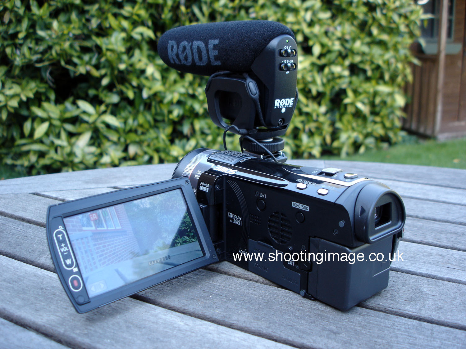

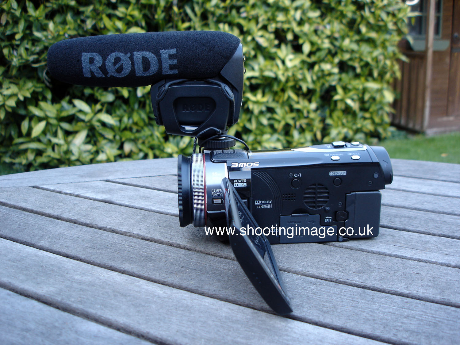

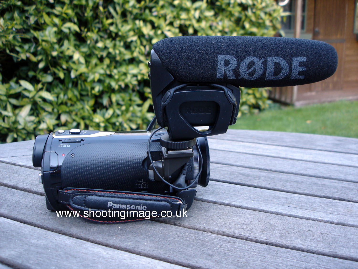

Well the VMP arrived at my studio this morning but I've been working all day (with a client present) on some corporate web demo edits so I have only now had a spare hour to look at the new VMP before I head down the pub.
They were not kidding when someone said "you double the weight of the Rode VMP when you put a battery in it" - it really is VERY light and you immediately wonder if it'll withstand the rigors of professional use that the name implies. Worry not I thought, it has a 10 year guarantee (and I already know from personal experience with Rode that they are truly superb at sorting out any rare problems that might occur).
The VMP is almost exactly the same length as the TM900 and the fact that its so light means it should be a perfect match for such a tiny cam.
Next, getting the battery in (and yes I did read the excellent instructions first!). I have to say it was not easy, very fiddly and I thought, who the hell thought this was a good way to design a battery compartment! But once you've done it once, its obvious. It really is. I then re-tried it about 3 or 4 times, just to prove to myself that I could replace a battery in front of a client in a hurry, if I needed to, without looking stupid!!! Should not be necessary as the battery last very long time according to the specs. Some clients might still think I look stupid ;-)
Next those rubber suspension bands - yes they seem to come off all too easily. My oh my - I'll be Supergluing them in place (as I've described I did with my original Rode Videomic on this forum before). That will prevent what will become an annoying frustration for sure!
Then I came to put the Rode Videomic Pro on the TM900s accessory microphone shoe attachment. This is where I was a little surprised (actually disappointed). It would not fit!!!!....not without CONSIDERABLE force (and yes I had fully retracted the shoe tightening screw before I attempted this). So much force that I decide to give up before I had a load of broken plastic in my hands that was once a microphone.
Now I'm a very practical type so the solution was easy. It was obvious from inspection that the Rode VMPs metal shoe was a fraction (and I mean maybe less than 1 mm) too wide to fit into the TM900's metal shoe.
So, I took my brand new £149 Rode Videomic Pro and ran a fine file over both outer side edge surfaces of the Rode VMPs metal shoe to shave off the anodized black covering (and a tiny amount of the metal beneath). All is now well - it fits without any problems, like a dream. Like it should have done out of the box...Now, I have no idea if this is a manufacturing tolerance error with the Rode Videomic Pro's shoe being too wide or the TM900s shoe attachment being too narrow but its a simple solution that took me 1 minute to execute. However, if this is not just a one off, I'm sure it will probably annoy someone (somewhere) that they effectively have to alter a brand new, just out of the box VMP using tools just to be able to use it as intended.
Just had time to switch it on, check it works and take a few snaps of the set-up when I got home - and yes the VMP is still out of shot even on full wide. Phew! When I eventually get my free deadcat that may not be the case but for now all looks good. TM900 displays audio levels nicely in iAuto or Manual so it all looks promising. Sure, as feared, the cable is a bit long so I'll be sorting out the best way to deal with that when I have more play time.
No time for sound tests as it's a lovely evening here and just I'm off down the pub to see some mates!
Pics below to keep you going. More info soon. Cheers!

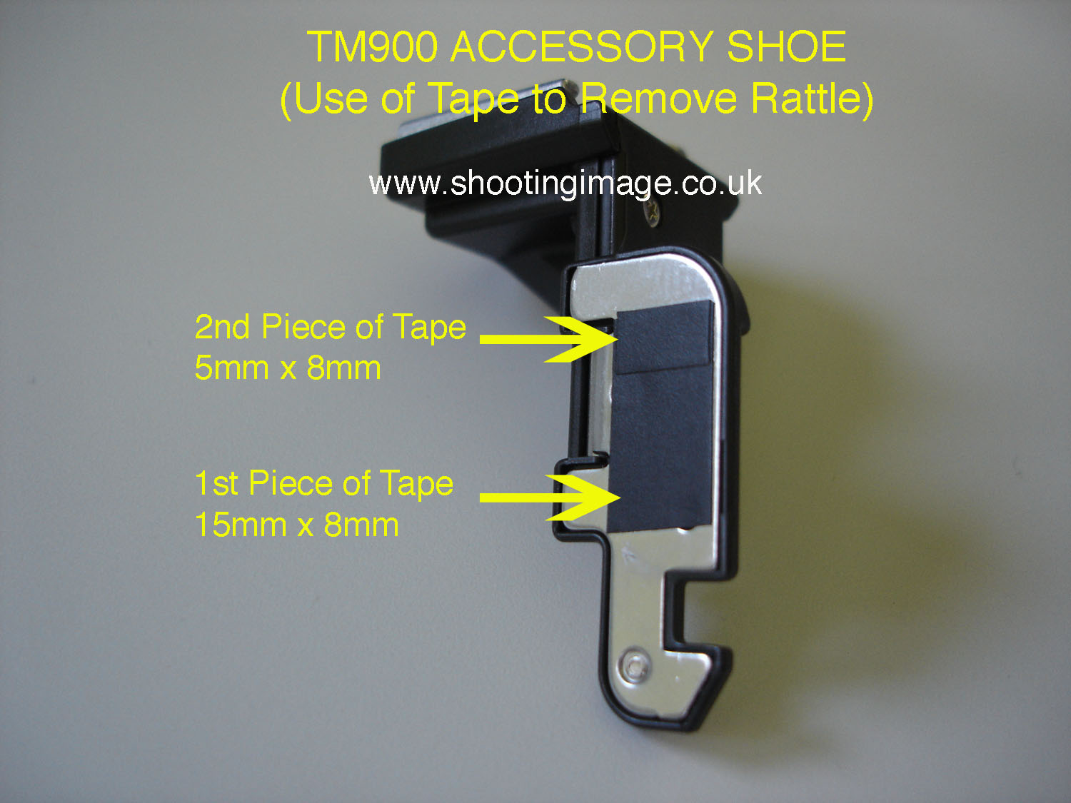

Panasonic TM900 - Mic Accessory Shoe (Tip to Remove "Rattle")
Another tip for you all.
I noticed that the TM900 accessory shoe rattles a bit when it's got a mic like the Rode VMP or SVM on it. It's almost as if the metal shoe fitting that it slips down into (on the side of the camera, under the cover) is very slightly too big - and we are talking fractions of a mm here again. It's a beautifully engineered thing but obviously any unnecessary play or noise is not desired so, again, it was a very simple and (at least to me) obvious solution.
I cut a small piece of electricians insulation tape (15mm x 8mm) and stuck it onto the shiny silver metal surface of the accessory shoe. That worked a treat, much reducing the play but it still had a tiny amount. I tried doubling the thickness by placing a second identical piece of tape firmly over the first one but that was obviously way too tight to even slip down into the accessory slot on the TM900's side. Don't force it! So, by trial and error, I found that all I needed was a tiny extra peice of tape (4mm x 8mm) stuck on top of the first piece at the upper end (nearest end to the part that takes the microphone above it). Obviously, tapes come in many different thicknesses but you get the idea.
Now it slips in nice and snuggly, just slightly tightening up as you push it the last few mm into the slot to lock it.
Simple, no more rattle! I'll post a pic shortly. Maybe my TM900 is an odd ball and other Panasonic TM900, TM700 etc. don't have this play with the accessory shoe - but if they do you now know a simple solution!
I'd actually recommend you put the smaller piece of tape UNDER the second longer piece as its more likely to stay in place with much use but I've deliberately pictured it the other way round just so you can see what I'm up to here.
Pic now attached - should be self explanatory.
UPDATE: Been trying out the Rode VMP today (with some family stuff) and I did some "with and without VMP" shots so I could directly compare cam audio to Rode audio on my computer tonight. The difference in audio quality is striking. I suspect I'll rarely use the TM900 without the VMP on it in future!
