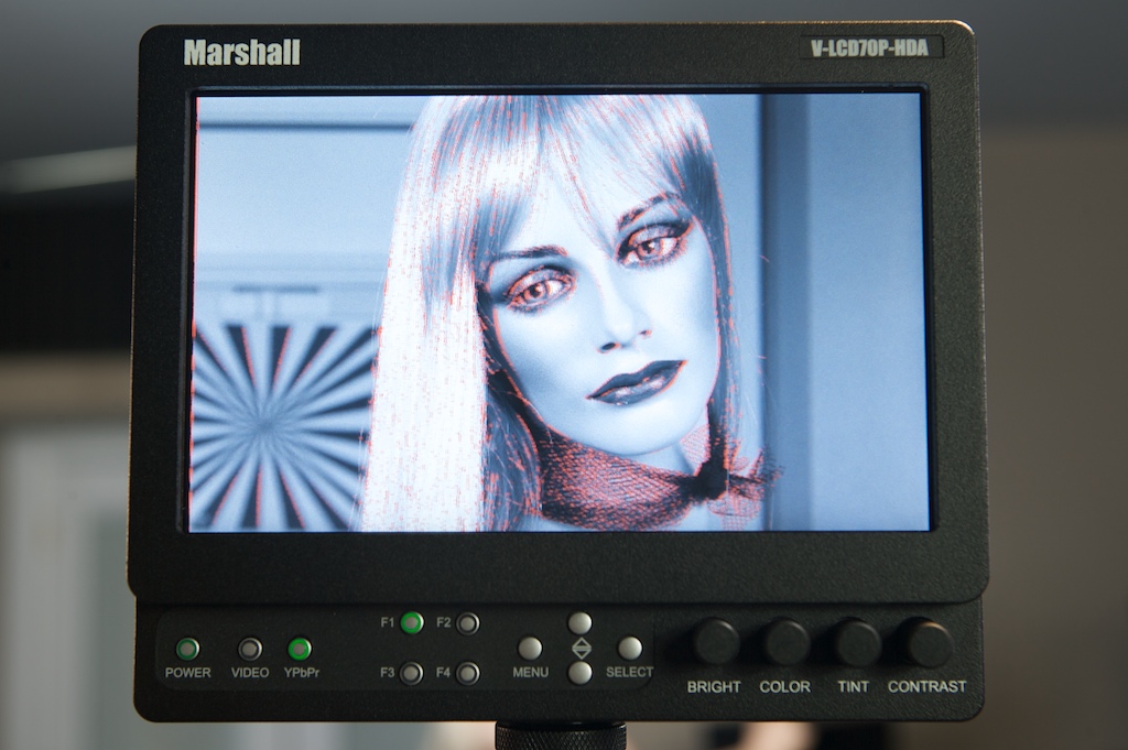

Man, I'm even more excited now! The Peaking is Red - this thing is going head to head with the Panasonic at $1000 off and better powering options!
From manual :
"Peaking Filter (Focus assist)
The Peaking Filter is used to aid the camera operator in obtaining the sharpest possible picture. When activated, all color will be removed from the display and a black-and-white image will remain. The internal processor will display RED color on the screen where sharp edges appear. When the camera operator adjusts (racks) the focus control (on
the camera lens), different parts of the image will have RED colored edges. This indicates that that portion of the image is sharp – or in focus. Final focus is achieved by racking the camera lens focus control back and forth until the desired portion of the image has RED colored edges. Please note that this feature is most effective when the subject is
properly exposed and contains enough contrast to be processed."

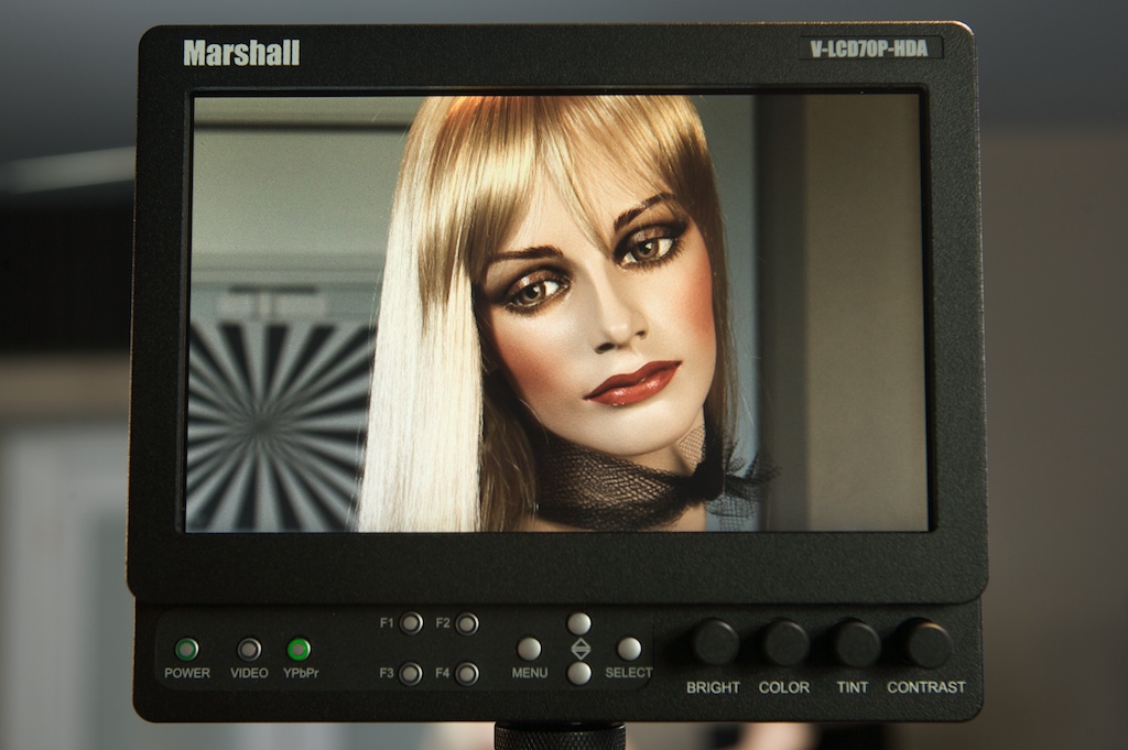

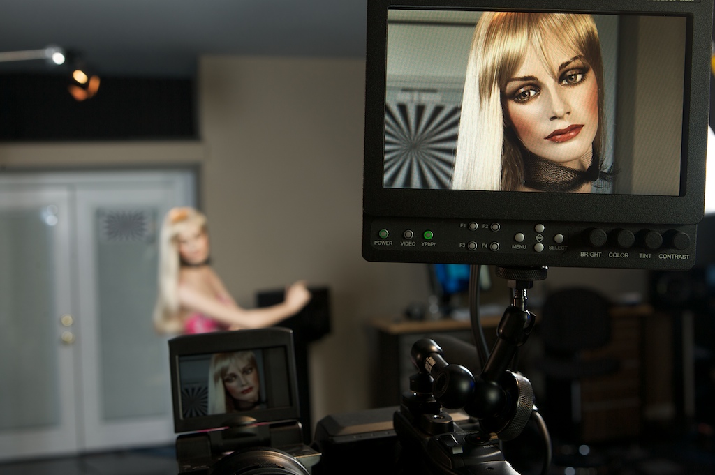

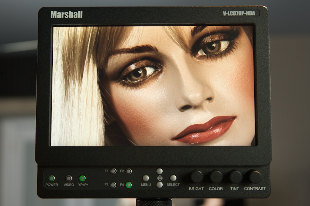

Just got our Marshall V-LCD70P-HDA in. Here are a few pix. It's even cooler than I ever imagined!
There are 4 one touch user Presets with buttons F1-F4 right on the front. I have mine set for:
F1- Peaking
F2- Markers
F3- Pixel to Pixel
F4- Freeze Frame
In the pictures below, you'll notice one that is a close up. This is demonstrating pixel to pixel mode with the same framing as the previous pic.
The build quality is very nice - metal around the front and a solid plastic on the rear. Yet, it doesn't feel heavy and weighs just 1.3lbs. The color controls in the menu allow for serious tweaking with not just the brightness, color, tint and contrast with the knobs on the front, but you can go into RGB Bias and Gain for each color channel - Red, Green and Blue. Plus you can feed bars in from your camera and turn on Red, Blue, Green or Mono (B&W) and really calibrate. The Marshall V-LCD70P-HDA is a pro piece of gear.
Starting at $949 for the Sony, Panasonic and Canon versions and $999 for Anton Bauer and IDX versions. Plus, you can use your dvinfo.net 5% coupon. Marshall Electronics 7″ LCD Monitor at DVcreators.net
