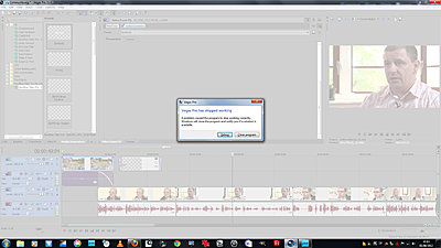

My crashes always seem to happen when I've added an effect on the video track. The most recent (see attached screen grab) was when I was closing the Color Corrector. Vegas just froze and locked and didn't even give me the option to send an error report.
NewBlue Titler was a problem in early versions of Vegas 11 for me, but since recent patches (and as long as I close the Titler window) it seems more stable.

Matt the latest NewBlue Titler instantly crashes my Vegas 11 when loaded. In Vegas 10 I always had the problem of Vegas crashing during playback when I applied effects like Magic Bullet. I had to stop playback and then apply an effect.

Hi Nicholas, I'm using the NewBlue Titler version 120402, not the very latest version, following advice on this forum.

Matt, build 120402 *IS* the "latest version" for Vegas Pro.
