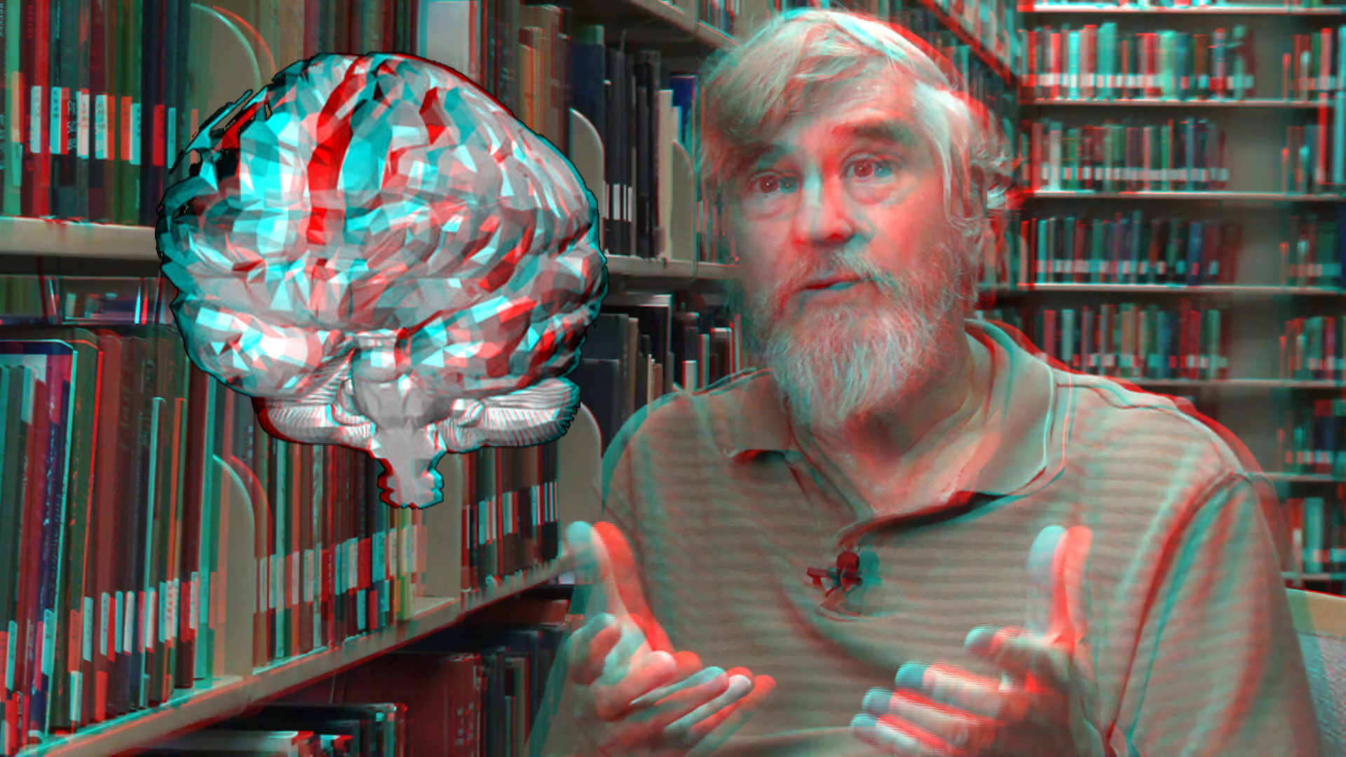

I'm finding this sync/lag in other files, as well. Since the interview is about consciousness studies, I'm learning to animate a 3D brain model in 3D Studio Max, to bring into the shot with my dad, just ahead of him in z-space, so the model can illustrate the structures and pathways, as he talks about them.
I've had a very complicated QC process, especially since I have ported my project over from Vegas to FCP. So I render from 3Ds Max, bring the image sequence into Vegas, export an M2TS, sneaker-net it to my Mac, transcode it to Cineform through ReMaster, mux it with Neo 3D, and then finally test it on the FCP timeline.
But the weak link in the chain has consistently been ReMaster, which keeps changing the duration, and/or lopping off the end of the source vid. I wonder if the results would be better, with a different input codec?
Anyway, I found a more elegant workflow, just using Vegas as QC, but eventually I'll have to get back into FCP (probably via After Effects), so Cineform is likely to be part of that mix, at least until I can save up enough for the Dashwood Tool Box.
I wonder if anyone has any experience working with Bino's 3D plug in, or OS3D, and can advise about their usefulness. I don't mind some back-bending to make the process work, but the more elegant the solution, the better!
