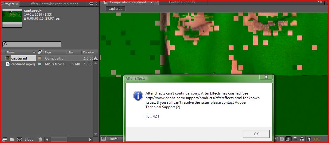

Mitch, your computer must have some sort of problem, or the clip you uploaded didn't include the "red zone" frames in your footage. I also imported into an HDV 60i sequence and had no trouble with the clip on a QX6700 machine booted to a partition with Vista x64 SP1, in CS4 version of PPro and AE (Vista and CS4 fully updated as of this afternoon). Imported, fiddled with a few different effects and it all behaved properly. Really doubt it is the camera.
I believe the red frames indicate a dropout that the capture module of PPro identified; in old versions it used to be that dropouts caused a capture abort or other unfriendly anomalies. Did you run a head cleaning tape for a few seconds with this new camera before starting to shoot with it? That is generally recommended.
If you have CS3 and CS4 installed on the same partition, it is possible that they conflicted. I had similar problems with CS2 and CS3 (really messed up the system to have them co-exist, which it SHOULDN'T do, but did), which is why I have CS4 on a separate partition (so I can use either CS3 with Cineform Prospect or Adobe CS4 without Cineform without worries, pending their long-awaited upgrade to fully support CS4).

Here's what I get after importing it into AE and putting it into a composition. Does anyone have an idea of why this is happening to me and only me?

Pete, I do have Premiere Elements 3.0.2 installed on the same partition as PPro on both computers. Could this have something to do with it? But I've been using PPro with SD video taken on a different camera for some time now with no problems.
