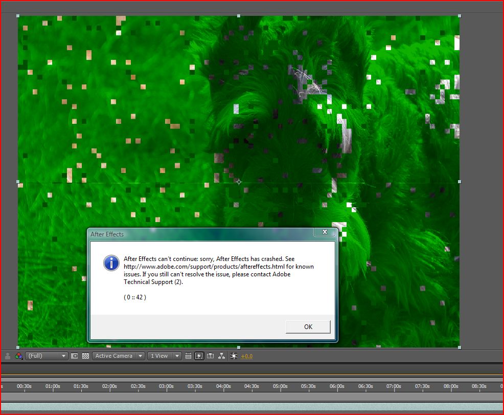

Here's a screen shot of the error in After Effects.

My guess from that screen grab would be hardware: faulty firewire cable, or firewire socket? Or possibly camera circuitry or the tape itself (that last one would be easy to rule ... out by trying another tape).
Also, once you connect to the computer, I believe its normal for those HD>SD conversion options to be grayed out. You dont want them anyway. Good luck!
