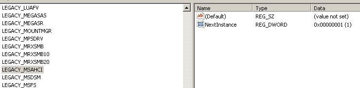

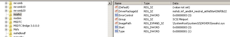

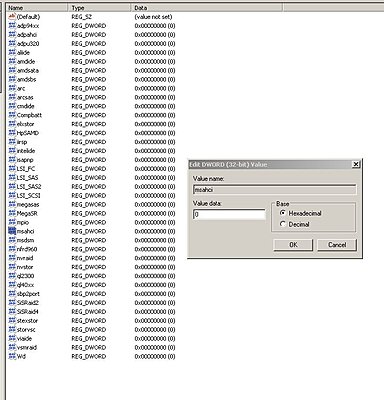

Ok... I don't know if this is good or not.
As per the first attachment, it looks as though it's already set to zero... Have I got the right one?
Searching just for AHCI produces a whole other tree as per the second attachment, though I have no idea of its relevance...
There's also a LEGACY MSAHCI section which has a "NextInstance" valuse set to 1, a whole msahci section that I don't understand... Do you remember off hand which one you had to change?

Ok I changed a value in the registry, went back to BIOS, enabled AHCI, booted, got BSOD.
Went back to BIOS, Disabled AHCI, booted.... Blue Screen!!!
So I think that whatever I did in the registry has blown my chances of a successful boot regardless of the configuration...
Maybe it's time to go back to zero and install Windows7 again...

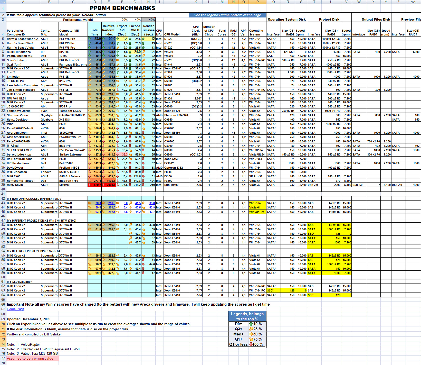

I took your question to heart and have updated the spreadsheet with legends. Look here:
