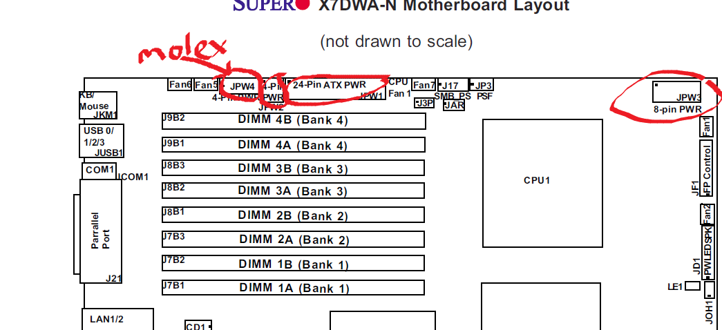

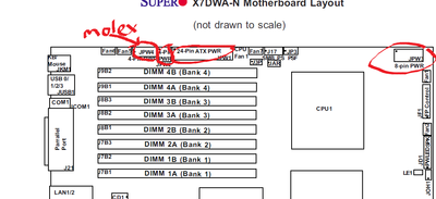

The disks:
Ok, after hours of Googling and trying to solve the problem of the portable SATA drives not disappearing from Windows Explorer even after they had been disconnected and powered down, I found and downloaded a program called HotSwap from here which allows me to deactivate the drive before unplugging it. This was imperative as I had a drive get corrupted by removing it, thinking that no data was going to/from it. Luckily it was a backup, because there was 270GB worth of footage on it!
Now I can be sure.
The power:
As far as I can tell (and I'm not too switched on when it comes to this stuff, all of the power connectors come straight from within the power supply and go straight to the motherboard with no adapters.
Also, looking at the motherboard manual, it looks like all that is required is one 8 pin (plus the other stuff). Am I right?

Old December 22nd, 2009, 11:02 PM   #67
Join Date: Aug 2009
Posts: 1,554
You are totally fine and I think this confirms the use of Molex adapters. I looked at pictures on newegg to confirm, and there is the 8 pin above the top cpu and there is the 4 pin + Molex you pointed out. Because Supermicro builds a server class board like this, then its certainly ok for boards without the molex connector.
