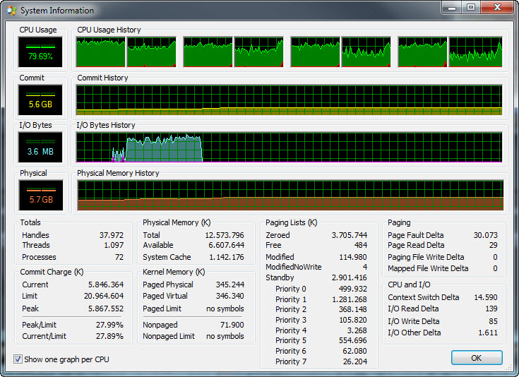

Although directed at Graham, allow me to give you my results, exporting to H.264-BR VBR-1 pass, target 25 and max 30, 1920 x 1080 25i with AC3 5.1 448 Kb sound, results in these rates:

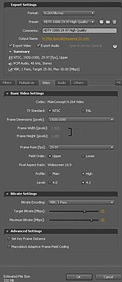

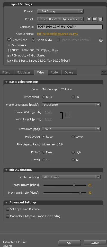

Rob - these are the export settings for the encoding I mentioned earlier. The original clip was 1080i AVCHD from a Canon HF10.
