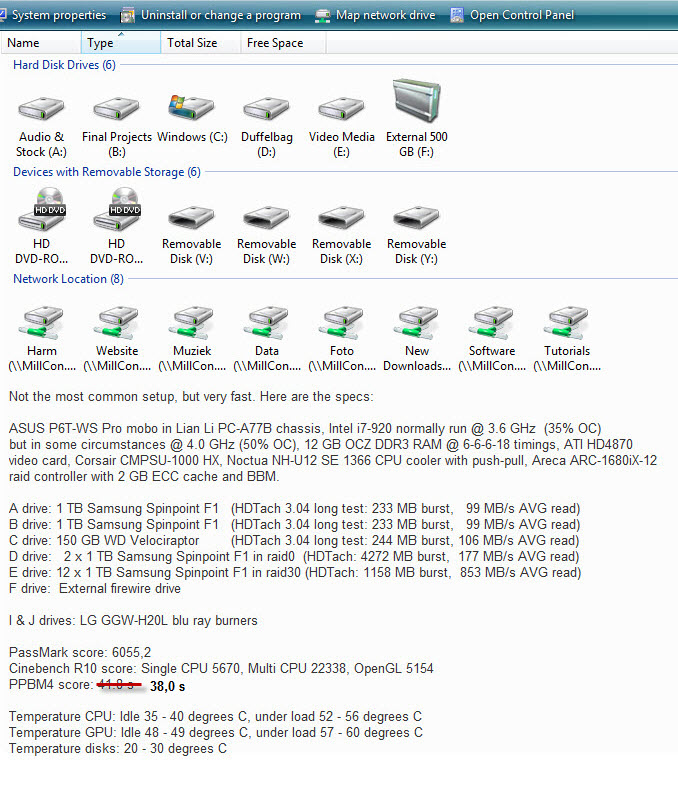

This is my setup and my workflow is usually XDCAM/HDV/DV with 5.1 sound exported with AME to H.264-BR/MPEG2-BR/MPEG2-DVD/MPEG2 I-frame 1920x1080 for further encoding with HC.
I suggest you try the PPBM4 home page benchmark and mail the results to Bill to see where your system performance is in relation to others. Maybe that will give an inkling of what is going on.

Thanks for posting your system info, workflow, and Bill's PPBM4 link again for the umpteenth time, Harm. Just speculation on my part, but most people don't have the super-speedy RAID setup that HARM has. I wonder if on some systems the h264 encodes are actually limited by disc write speed rather than processor as one might normally expect?
