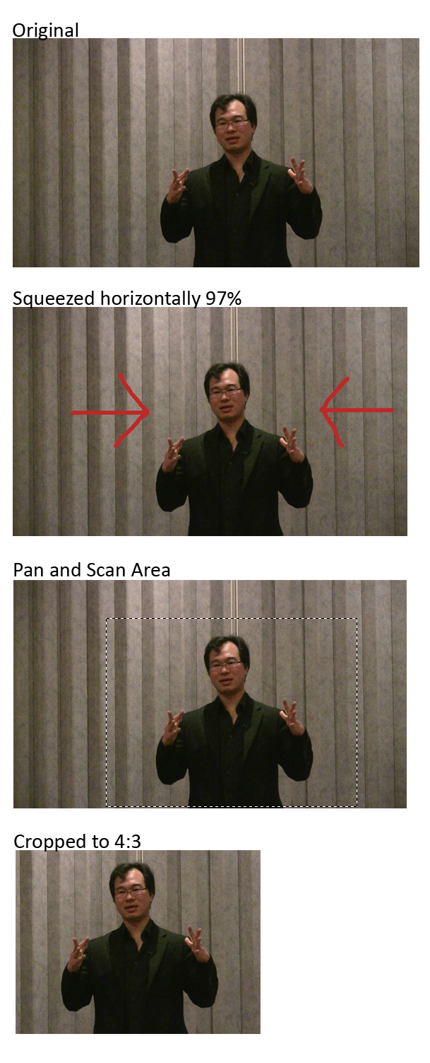

I wonder if it's possible for us to do a pan and scan type process with our HD video? I ask because someone gave me some footage from the weekend where the composition was way too wide and large and I'd like to save the video, composed better, an SD quality.
Given the pixel resolution it should be possible. I know that's how they convert 35mm film to fit TV, but when it comes to video, can Premiere do it?
I can crop video in premiere but it will save the video at the same resolution, but all pixelized and looking wonky. How would I save 1080i video pan and scanned to 720 (p) or regular SD (640) which will still look decent on Youtube.
Here is an example (note, I also squeezed the footage to 97% horizontally first):
http://www.vancouversocialboard.com/...s/pan-scan.jpg
Can anyone give a tutorial?

I would assume there is a way to crop/get 640x480 out of 1920x1080. Even cropping doesn't work, it still leaves a black area in the viewable area.
Anyone have any ideas?
