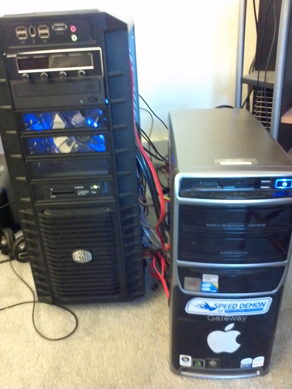

Hello, i have had the same system configuration for over a year now, and suddenly i am having problems with CS5 during render and export sequences, sometimes my graphics driver konks out (same one for 6 months, card works 100% in old system); at no other time do i experience issues. Here is my system specs and breakdown.

I tested this rig repeatedly at bare minimum specs, and maxed out specs; suddenly i keep losing my RAID array. All parts have been in and in this configuration for over a year now.

I suspect the issue is my RAID array dropping out, which was set to stay on full power and never spin down or idle the HDD's, now i have it set to idle in 20 minutes, low rpm in 10, and stagger power at 3 second intervals, to no avail; i STILL have issues where it drops out (beeps endlessly) and sometimes my graphics driver goes berzerk now.
I tested and checked everything and came to the conclusion my PSU isnt up to par; in fact here are the voltage readouts (averaged between what i personally tested on the probelt and what AI Suite says, which were almost identical)
12V@ 11.86v
5v@ 4.92v
3.3v@ 2.92v (suspect this is the culprit being 12% low)
Right now i have done something i feel horrible about but im in the middle of a project and need to finish by tonight, so i umbilically linked the SATA connectors from my old editing machine (after disconnecting all other SATA devices' power, leaving only a SATA powered Intel SSD, the motherboard, CPU and exhaust fans, and 9800GTX+ card powered on a 400w PSU. I also disconnected all extra fans and accessories on my main rig. Suddenly 3.3v is registering at 3.03v and both my graphics card and RAID card are not on the fritz.
My question is, what size PSU should i go for? I REALLY dont want to spend $150+ on a PSU or get something insane, but i have a feeling 750w isnt cutting it, or this one is bad. I was leaning towards 1000w, but i have no idea what all the 80+ bronze/silver/gold ratings means.
Since i did this hackjob surgery, essentially piggybacking power from a second PSU for half of the RAID array (which i am only doing because i need this project finished ASAP), everything is working fine. I should also say that when simply reviewing media, listening to music, watching shows or movies, or even doing a simple read/write operation, i NEVER have these issues, just in PP/AE CS5, and just recently (i do NOT update this machine at all).

First off congrats on the MacGyver fix, I never would have thought of it. That said as I started reading your post I was thinking to myself it was the PSU. I would probably go to a 800w or 850w and they do tend to run in the $120 to $150 range, but I don't think you have a lot of choices besides replacement. Unless of course you just go with the "marriage" you have now.

Well here are the results of a battery of tests i ran before spending cash on a power supply... it was only the 3.3v i was having issues with.
suspected culprits included...
graphics card drawing too much power
RAID array drawing too much power
faulty power supply
faulty motherboard
i used the umbilical procedure to eliminate each possibility (except for a bad motherboard). basically, too many disk drives on this PSU was causing my 3.3v to drop as low as 2.86, and therefor caused graphics issues as well as RAID array issues.
im awaiting a new PSU, in the mean time i am finishing a project with both systems on and sharing power supply duties.
