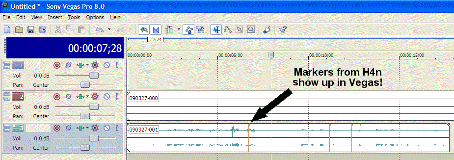

The good news:
The BWF formatting Zoom has included carries markers created on the H4n all the way to the timeline of my NLE (Vegas Pro 8.0c)!!!!

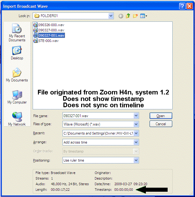

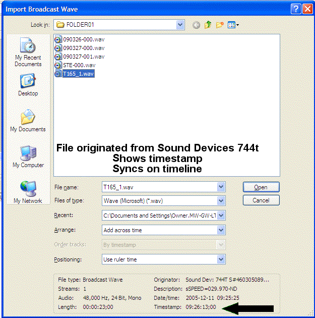

The bad news:
As of yet, the BWF timestamp is not correctly written in the file header. As far as timecode syncing in Vegas goes, it's not happening yet as it should, because without that timestamp Vegas doesn't place the media anywhere but at the start. As you can see on the attached screen grabs, the file creation date/time is written to the header, so workarounds are possible. (latest H4n system 1.2)
I'm contacting zoom tech support - I sure hope and expect this is something they can fix.

In that the file from the Sound Devices 744t works fine with Vegas' interpretation of BWF header info, and that there have been no reports I'm aware of regarding Vegas errors with timecode sync, I'm pretty sure this is an error in the way that the H4n writes the BWF headers. No response yet from Zoom, I hope this will be fixable.
