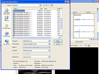

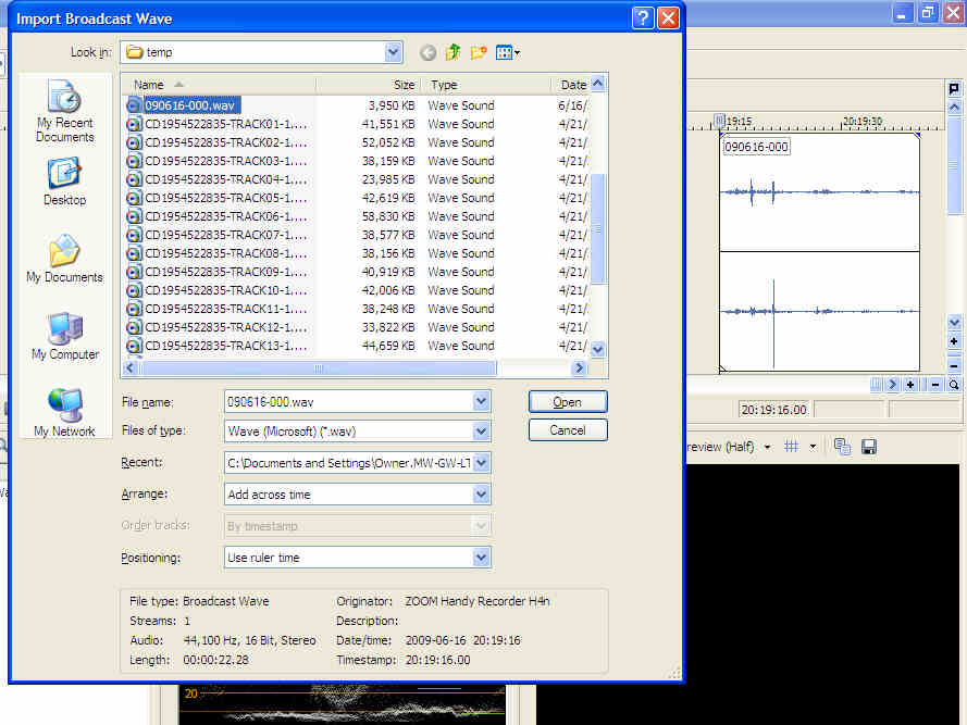

Got an email from Zoom - they wrote to say that the timestamp issue I reported has been fixed in the system 1.4 they released today. Yay!
Download Software
Downloaded, installed, tested, and it basically works close enough for rough Time-of-day timecode sync. Vegas now is able to interpret the timestamp info and drop the file in the correct location on the timeline - see the attached screencap.
This is no Sound Devices 702T or even Tascam HD-P2... but for $350 this is one handy little recorder. I've gotten a lot of use out of mine, and now, glad to get usable rough TOD timecode.
BTW, if you were waiting for the wired remote, it is now in stock at the usual retailers.
