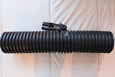

If we're doing show and tell, check out the "case" that I made for my Rycote s series blimp, shown below.
Garrett from this forum had made a case very similar to that of the original poster, and it was very impressive in person. But clearly overkill. It was way heavier and stronger than it needed to be, mostly because PVC pipe is super dense.
I spent an hour at Lowes walking down all the aisles trying to find some material better than the 4" PVC pipe, and found epiphany in the garden section. I bought some drainage pipe normally burried beneath a gutter downspout. It has several advantages over PVC:
1. Even though it has the same nominal 4" diameter, the drainage pipe has a wider actual inner diameter. This is important for the S series blimps where the fur is permanently part of the blimp; the 4" PVC was such a tight fit that the fur might get crushed if stored for a long period of time. The 4" drainage pipe had a wider actual inner diameter, and the ridges provide places for the fur to stick out rather than getting crushed.
2. The drainage pipe is much cheaper, lighter, and easier to work with relative to PVC. $5 total and easy to cut with tin snips. Like the PVC it's only available in 10' lengths, but I don't feel so bad about the environmental issues of wasting a few ounces of drainage pipe versus many pounds of PVC.
3. As a bonus, the ridges tend to "comb" the hair on the blimp every time it is slid on or off.
As you can see my "case" is just two lengths of drainage pipe that slide onto the blimp, with a short length in between that locks them in place. It fits perfectly in a bag with my boom pole and protects the blimp when I throw it in the back of the car at the end of a long day.

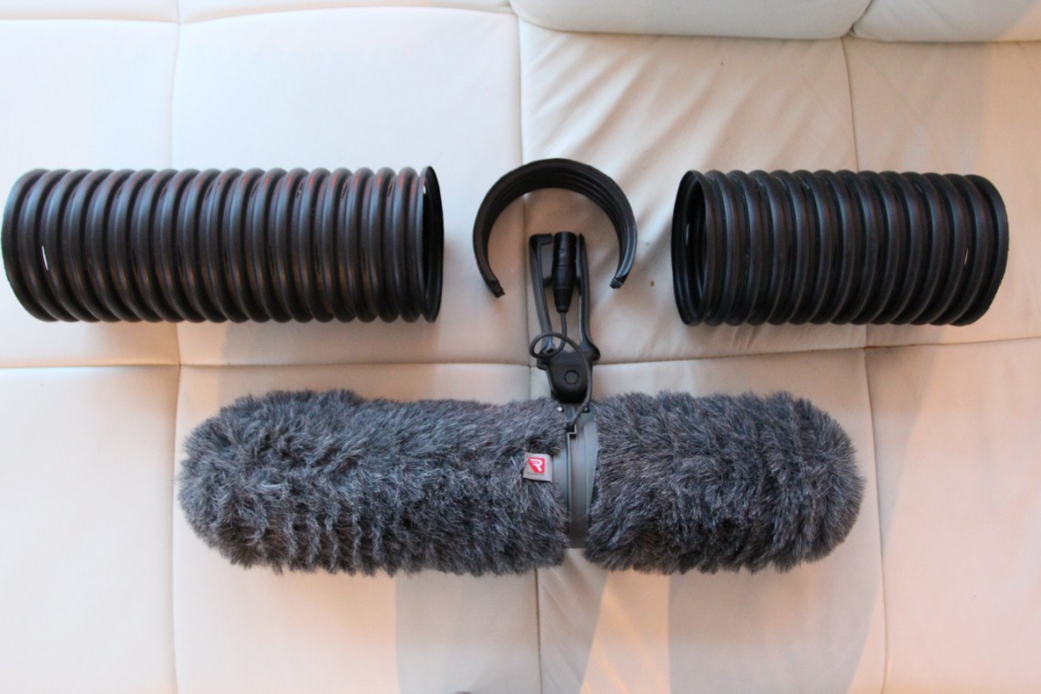

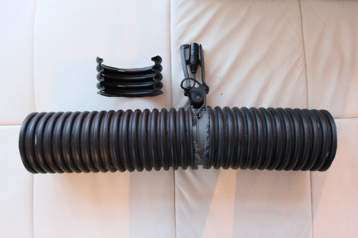

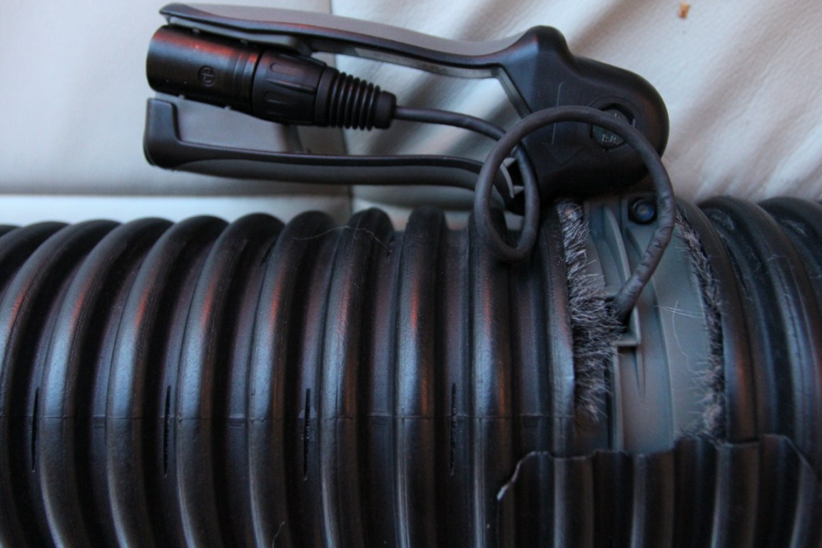

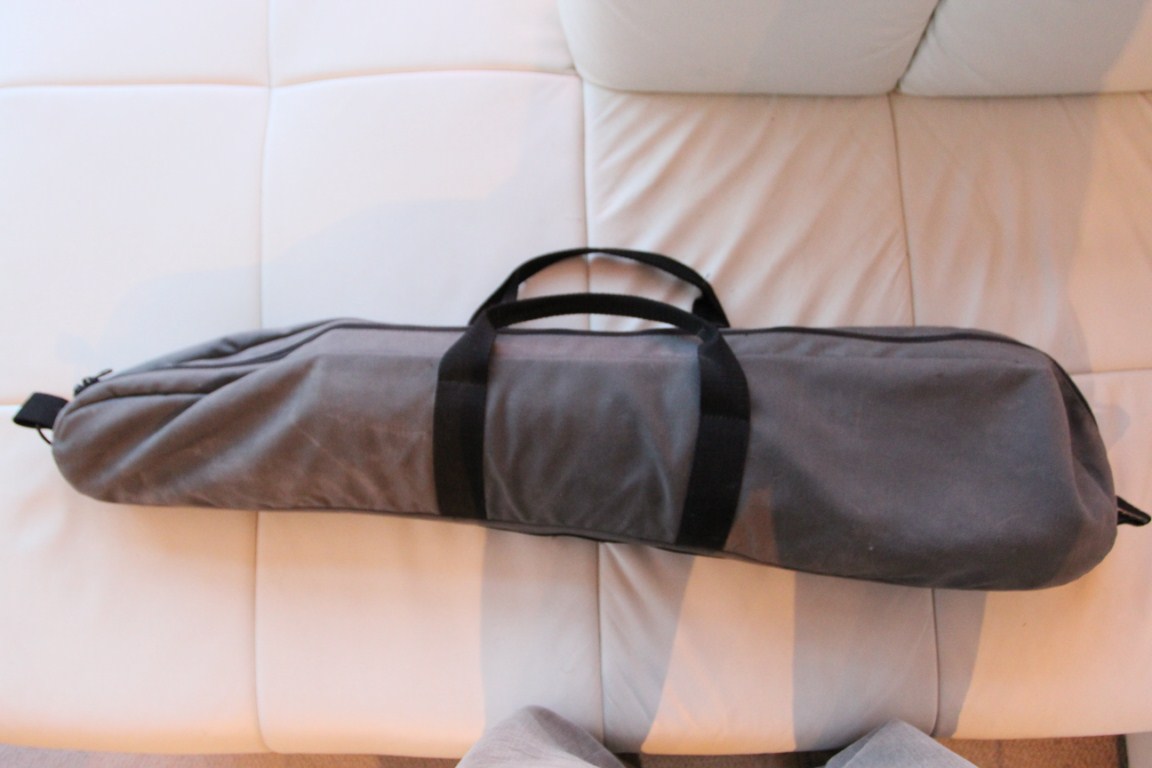

Here are the pics. As you can see the handle is left exposed, which greatly simplifies design of the "case". By the way this thing is plenty strong; I can do pushups without crushing it.

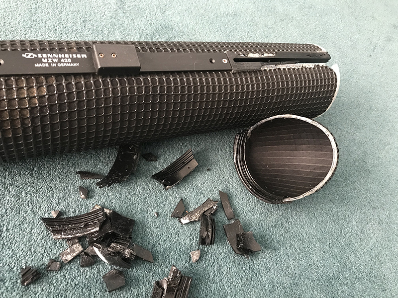

I have no suggestions as to what to get, but I do have a warning to stay away from padded soft carry cases.
A flight case fell over onto the one holding one of our rather expensive Sennheisers.
Totally destroyed it!
