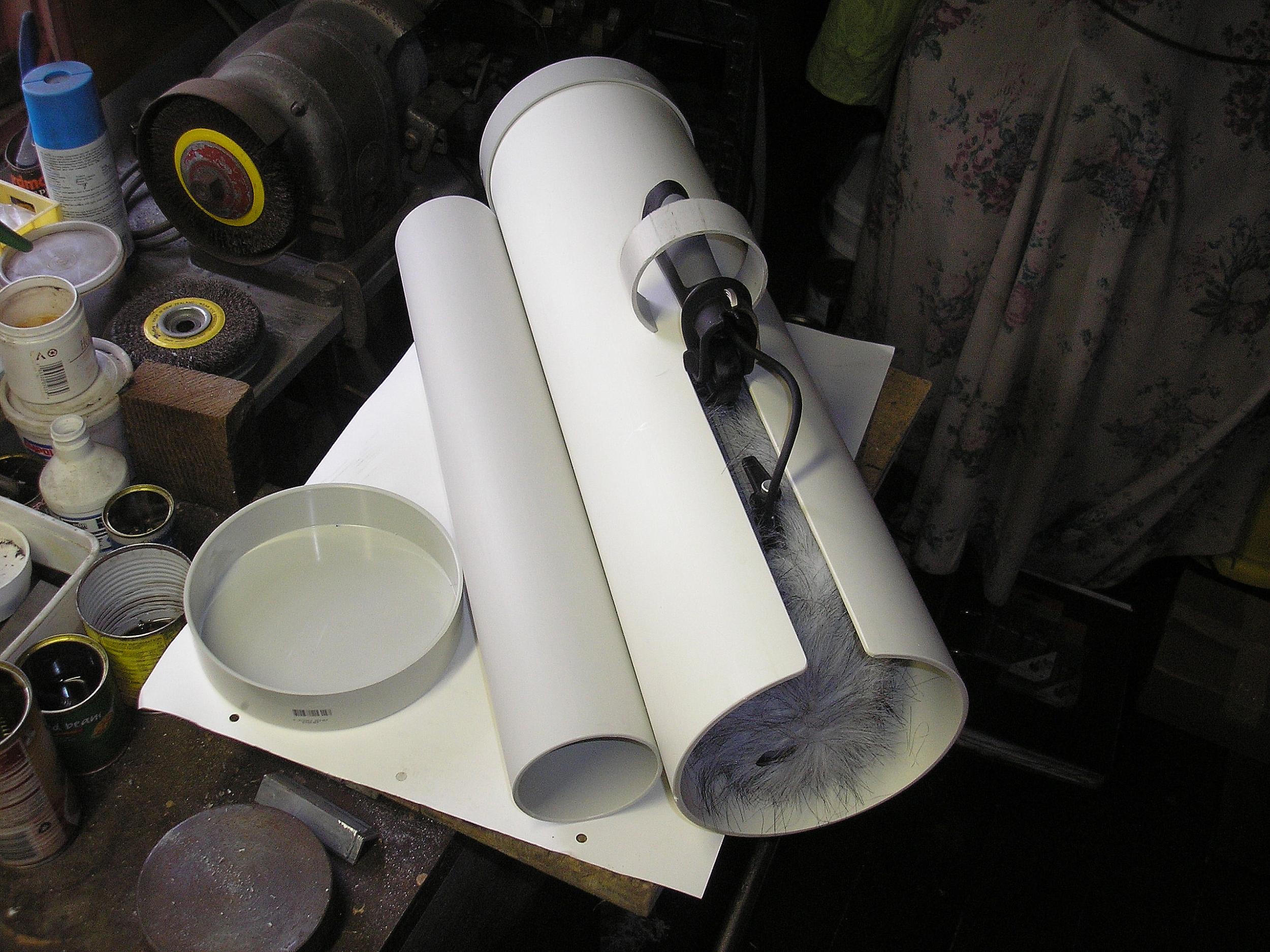

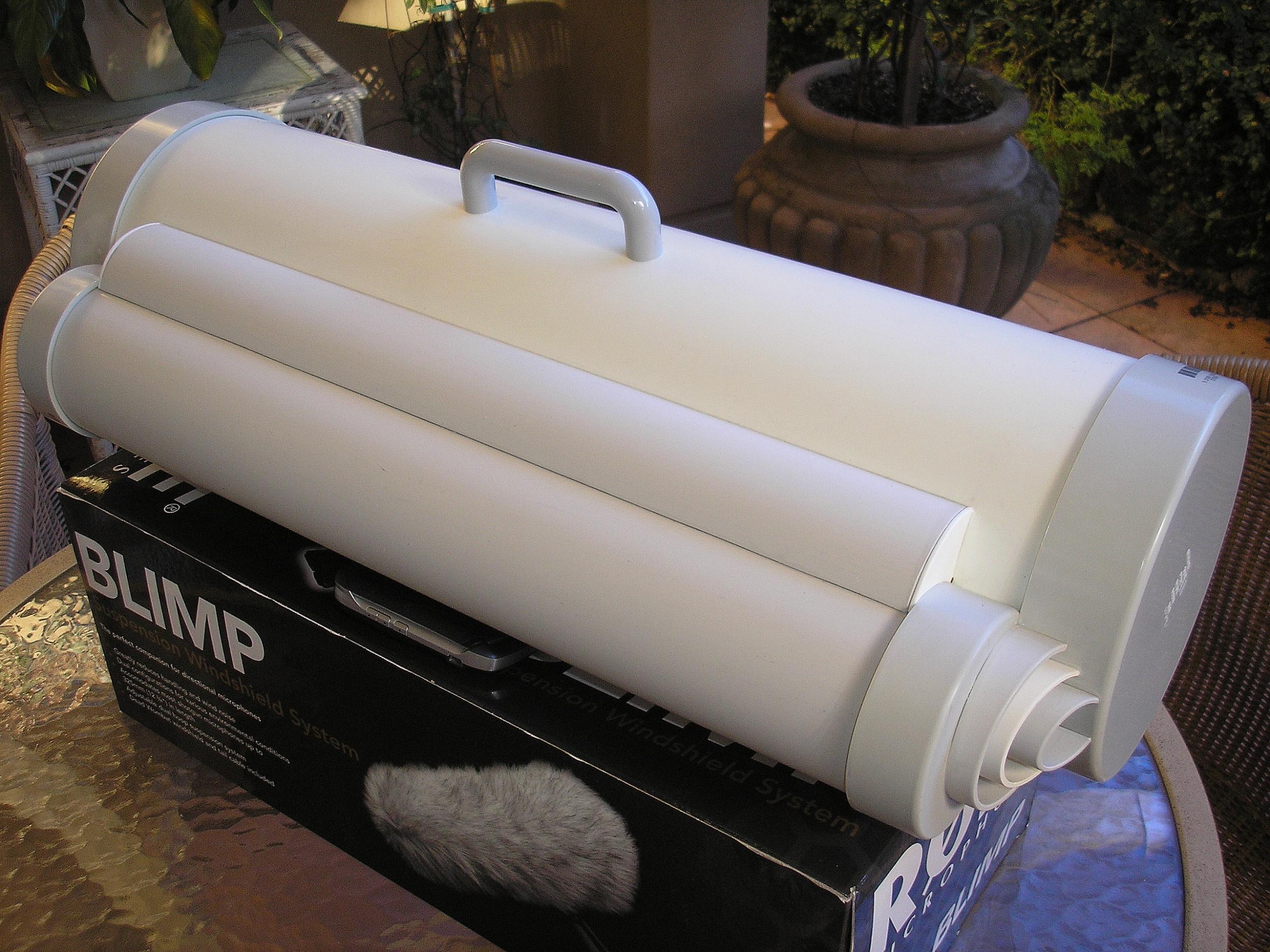

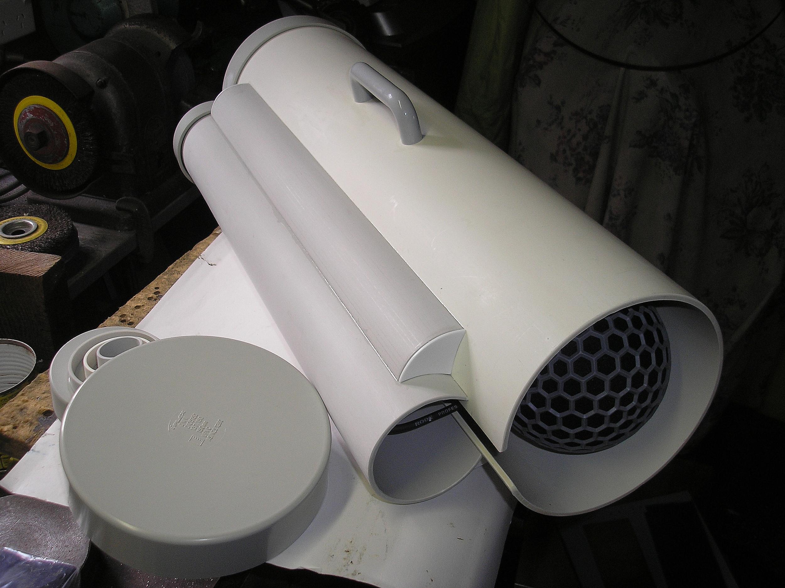

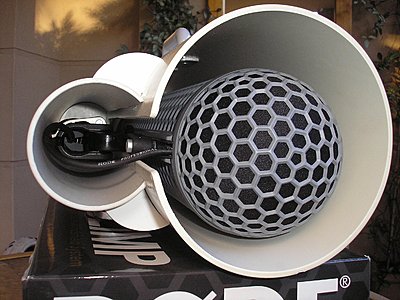

Hi all, I needed a case that can fully protect the Blimp with its Wombat wind cover and NTG-3 shotgun mic installed, ready to go. Take it out of the SUV or aircraft, pull the front cap off, pull the Blimp out, straighten its handle, plug it in and I'm good to go.
It's made from PVC water pipe from a plumbers supplies outlet. The main barrel is 58cms long 160mm diameter, lucky offcut, no charge. The top pipe is 80mm diameter at $9.50 for one metre. Its side reinforcing supports are made from the same pipe. The barrel caps are $8.50ea, the top pipe caps are $2ea. The handle cost $1.50 at Bunnings.

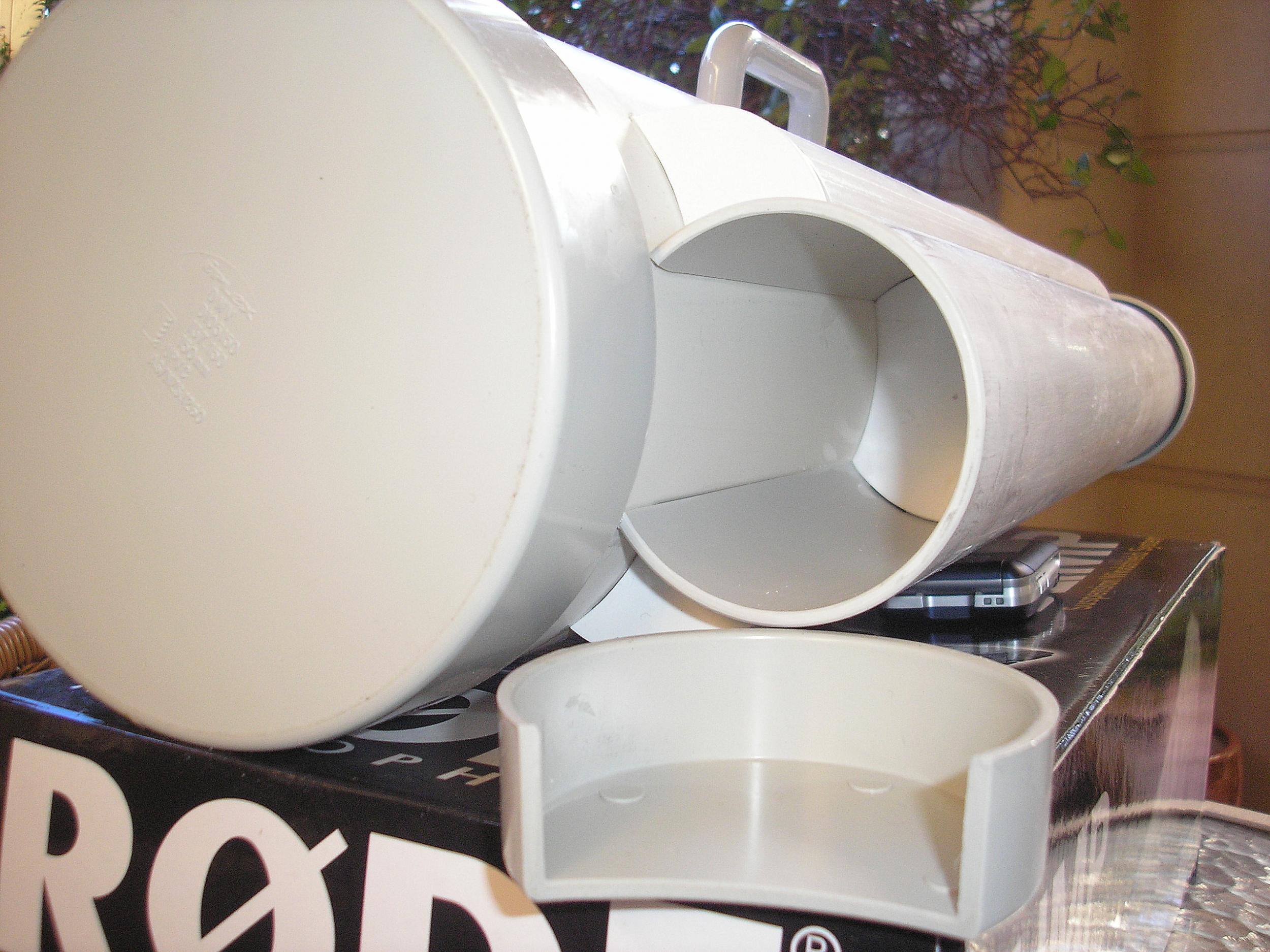

The cap at the other end of the top pipe (pix 4) pulls off to reveal a small compartment to hold the NTG-3 shot gun foam filter, Wombat comb, thread adaptors etc. The Wombat will store in the back end of the main barrel when not in use. Locktite 406 holds it all together, $25.28. My total materials cost ... $A57.28.
With a fully loaded Blimp on board, the case weighs 2.5kg. This is a right hand (when you carry it) model case ... construction time, 2 afternoons.
To store the Blimp with its Wombat laced up, static electricity will build up big time if you don't fit an internal barrel sleeve made from reinforced cardboard. Shown here during construction stages for clarity, and before a vinyl cover is applied.

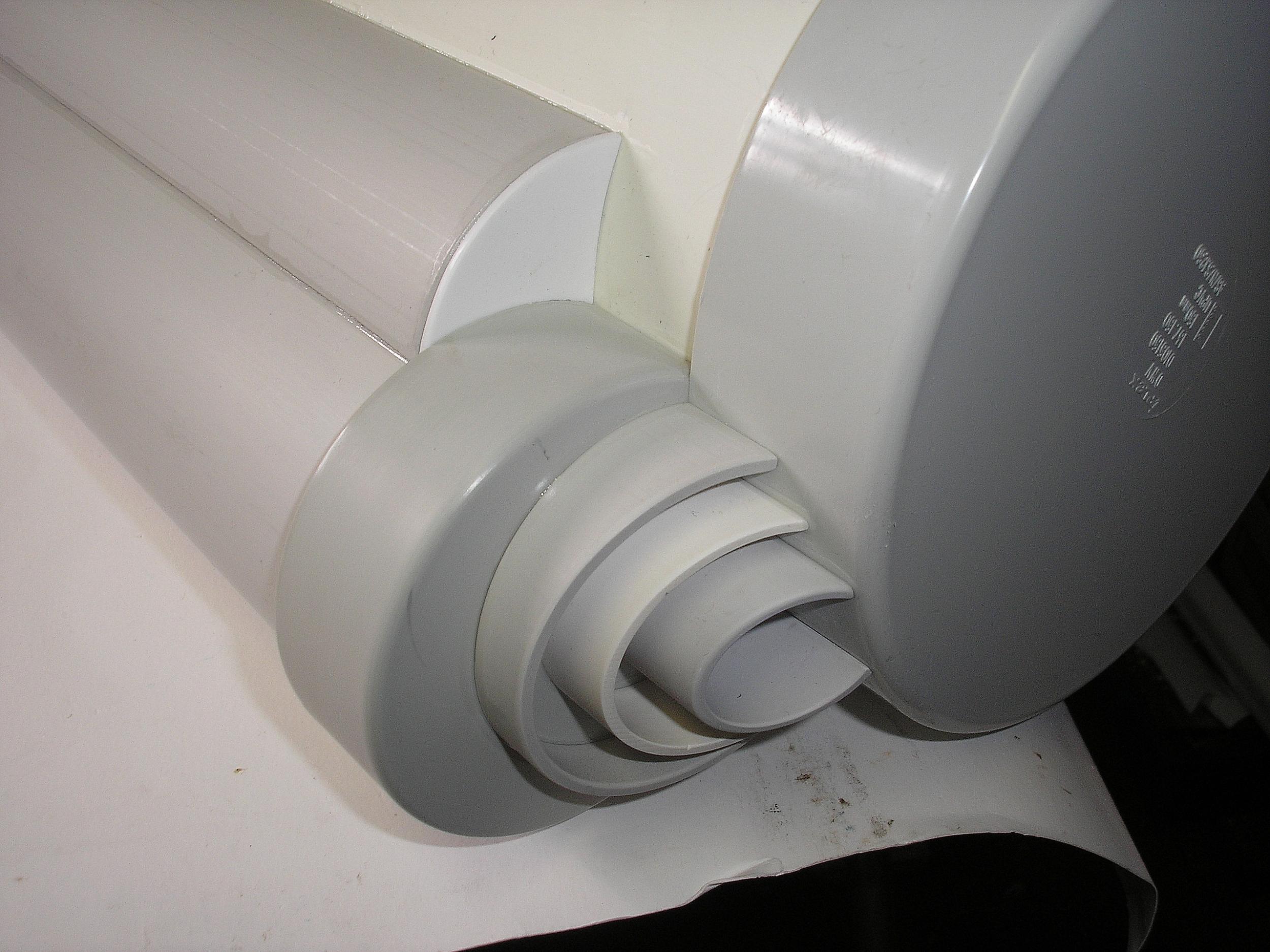

The handle has a reinforcing plate under it (pix 3) and is offset a few degrees so putting the case down on a flat surface, the main barrel touches first and doesn't jar the rig.
I turned the hose on it to find any leaks, Locktite 406 is good stuff, use that not any superglue.
