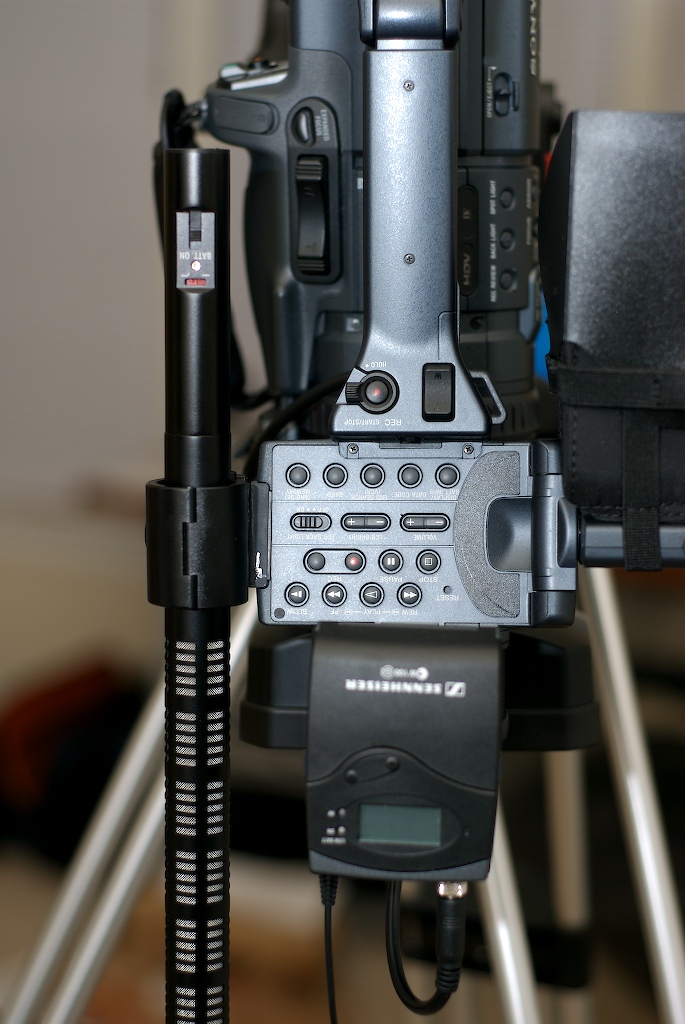

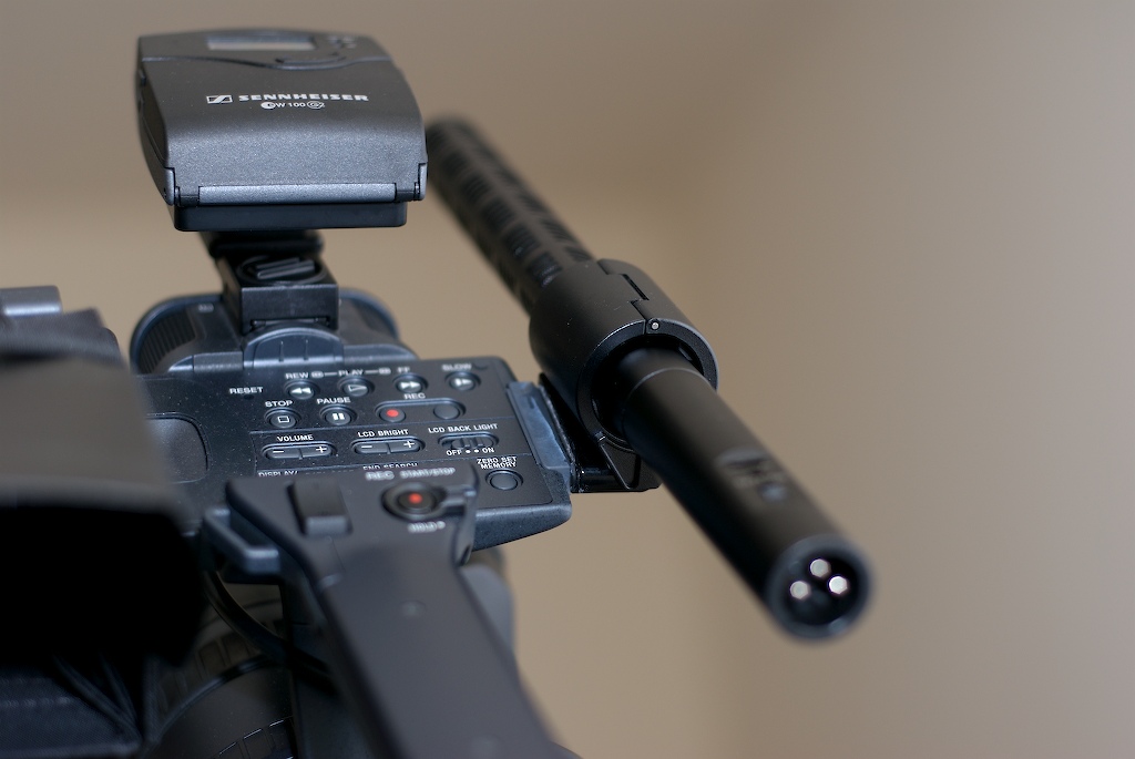

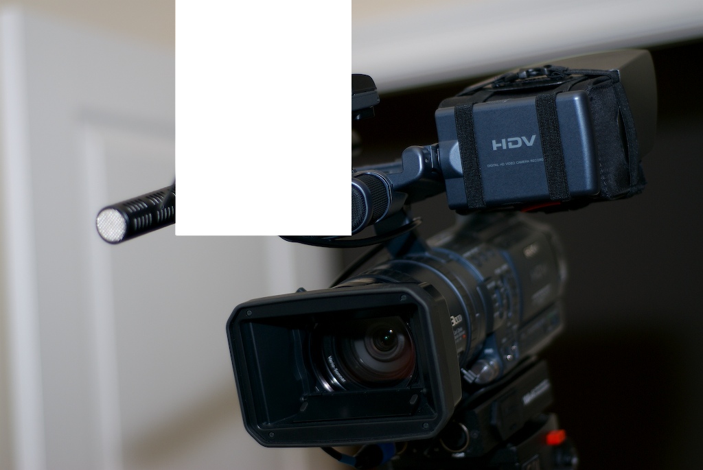

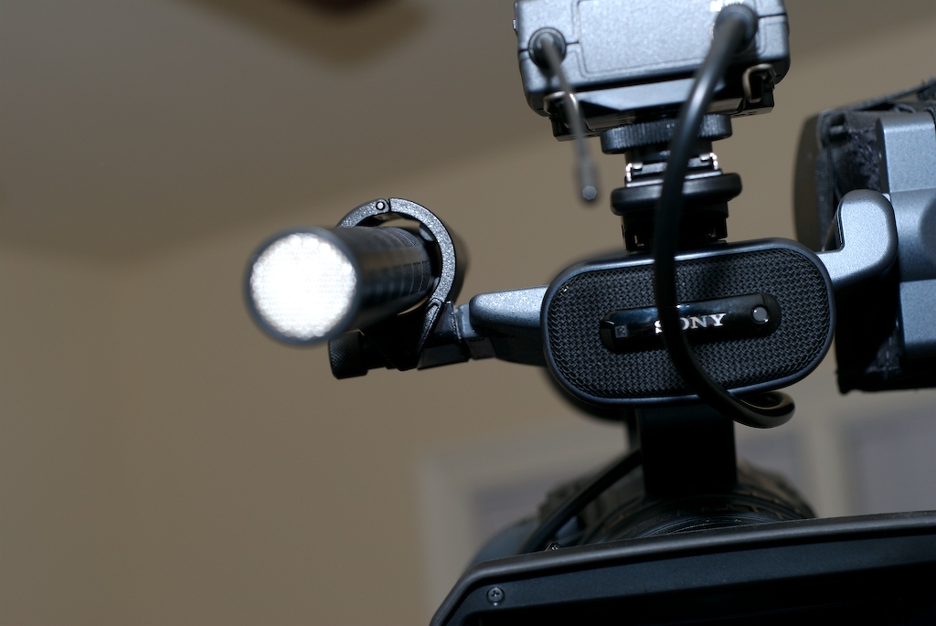

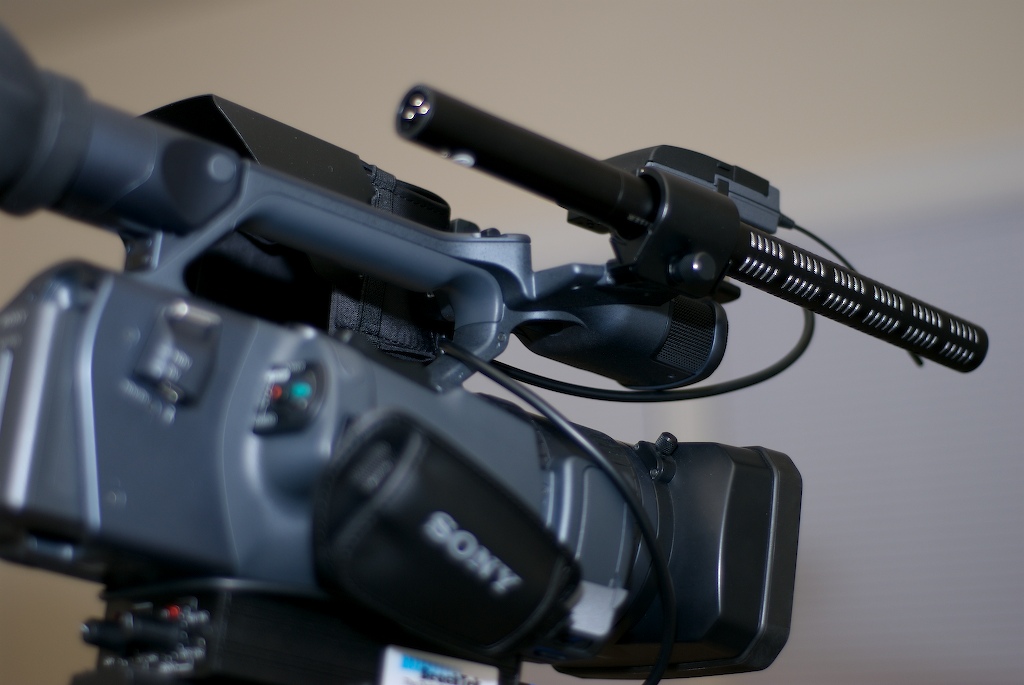

Old September 23rd, 2006, 06:49 PM   #25
Location: Sterling, Virginia
Posts: 226
FX1 or is it?
Well I received all my parts in last Thursday and finally got the chance to put it all together and heres the pics...ENJOY!!!
Adding a shotgun mike to the FX1-dsc_0017-version-2.jpg   Adding a shotgun mike to the FX1-dsc_0018-version-2.jpg
Adding a shotgun mike to the FX1-dsc_0019-version-2.jpg   Adding a shotgun mike to the FX1-dsc_0020-version-2.jpg
Noah Hayes is offline   Reply With Quote

Old September 27th, 2006, 04:12 PM   #28
Posts: 226
I ordered the part directly from Sony's business website, it cost around $65 which is a little high in my opinion for what it was. The XLR inputs would be nice, but theres no way I'm gonna crack open my FX1 to do that (a much more expensive modification also) and since I have my Beachtek DXA-6, I don't really need the built-in XLRs, however the Beachtek is HEAVY. Let me know how your mod goes if you wind up installing the XLRs...

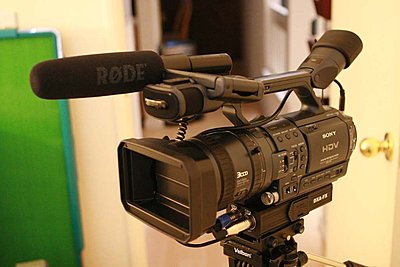

Old November 4th, 2006, 06:11 PM   #29
Join Date: Oct 2005
Posts: 45

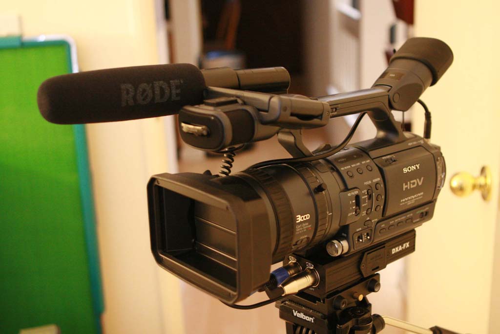

Pic - FX1 + Beachtek DXA-FX + Z1 Shotgun Mount Modification + Rode Video Mic
Here's a pic of my current setup with one of my FX1's. FX1 + Beachtek DXA-FX + Z1 Shotgun Mount Modification + Rode Video Mic + Sennheiser Wireless.
It's a little heavy compared to a bare FX1 because of the Beachtek but the sound and control is excellent! The shotgun does not get into the shot when using a Century Options Fish Eye.
Originally Posted by Fred Foronda
I need this mic...anyone has a picture of this mic on their fx1, I am curious how far it will stick out over the len's hood.
Christopher Cruz is offline   Reply With Quote

Nice work!! Can you get shot of how you mounted the Rode mic on the side, I'm interested in mounting it there rather than using the hot shoe mount.
Fred Foronda is offline   Reply
