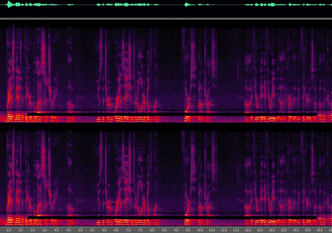

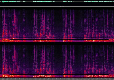

Old October 12th, 2010, 12:43 PM   #7
Location: Miami, FL USA
Posts: 1,505
If you have access to Adobe Soundbooth or another editing program that allows direct visual editing on the spectrum display, the ringing is easy to spot, select it and delete. For consistency, it would be good to delete that narrow strip from the whole take, as it affects the sound of the voice to a small extent. I am attaching pre and post spectra and pre and post .wav files of the small sample I did this with...see if you like the result...
In the post-cut wav, you will hear the small band of unaltered audio, followed by the altered audio, then ending with the unaltered clip, just as you see in the spectrum where the ringing was removed...the difference in the reverb, even with no feedback ringing, is why you might like to remove that small part of the spectrum for the full clip...just for consistency...
Need some help removing slight annoying feedback ring-postcut.jpg   Need some help removing slight annoying feedback ring-precut.jpg
Battle Vaughan is offline   Reply With Quote
