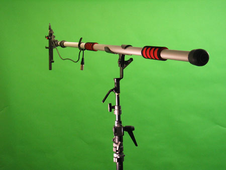

For what it's worth, here's a photo of gizmo I made which fits on a light stand (or whatever) and takes a 'boom pole'. The boom pole is actually a great, extending, aluminium, window washer pole slightly modified...strong and as long as...
Renton Maclachlan is offline   Reply With Quote
