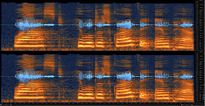

I've been staring at the first word in Izotope - I think the first word looks rather strange. In fact I think the whole thing looks a bit odd.
I've attached a screen shot.The striation pattern in the orange is quite noticeably different for the first word. Not sure what this is trying to tell me.

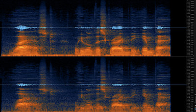

OK - I tried to more or less mouth the same words with a heavy emphasis on the word "Last"
A few things stick out
1) I'd make a lousy voice over guy (sorry)
2) The Izotope plot looks more like I'd expect vocals to look. Much smoother and less "striated" energy distribution at the lower frequencies, and relatively little energy at the higher frequencies as well as a bit less abruptness at the start of words. You can clearly see the way the frequency distributions shift upward during the pronunciation of the first word compared to the flatter more parallel nature of the plot of the original recording.
You can also see that I was sitting a bit to my right of the mics while speaking
Setup:
M/S Schoeps figure 8/wide cardioid into an SD 702 at 96kb 24 bit
Something is filtering/limiting/generally messing up the original but I have no good idea yet what it could be.
