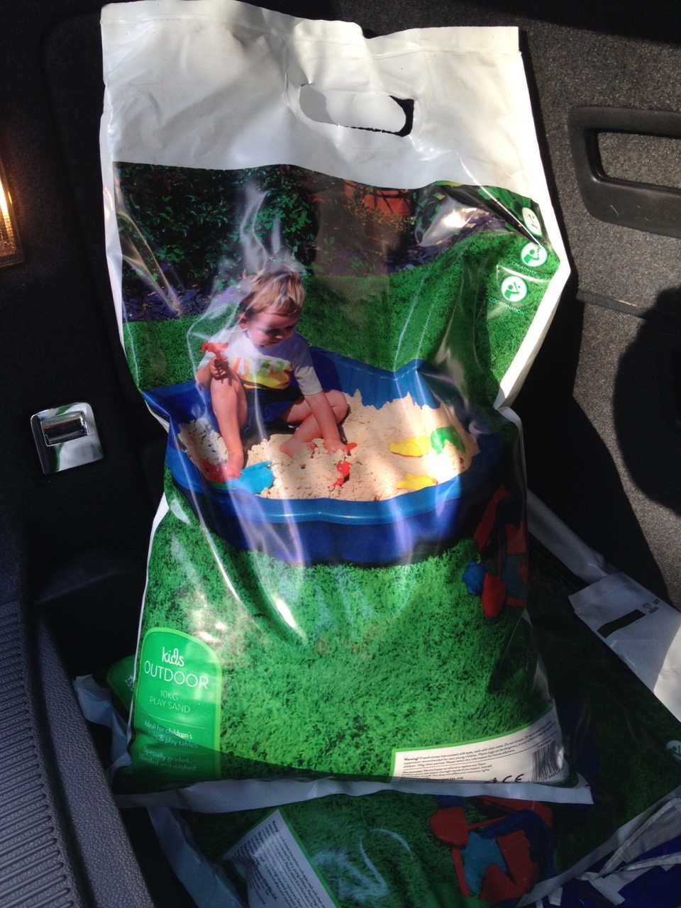

Here's my creative counterweight - a sandbag! But this one's from Tesco for kiddie's sandpits. The plastic bag is quite heavy duty but I still put it in a canvas "bag for life" to avoid damage.

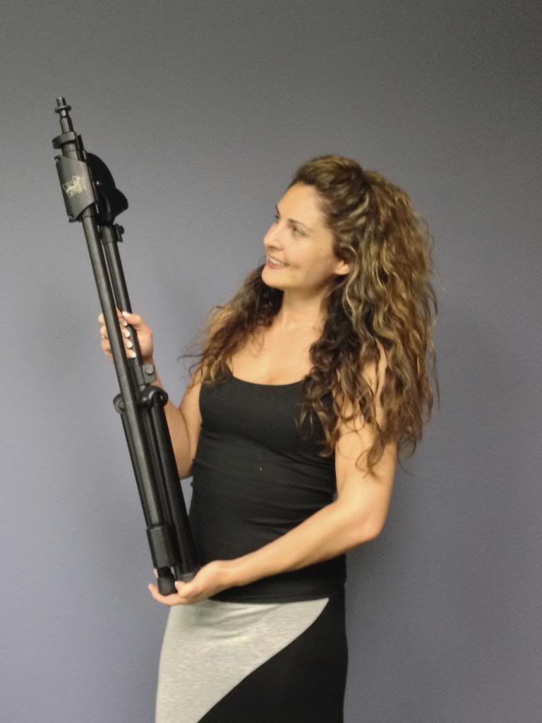

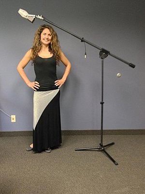

If it's for stand use only - then the best are Latch Lake (made in the USA).
I have the 1100 stand myself - it looks like a normal mic stand but is, in fact, a lot bigger.
The adjustment is by a special clamp, rather than by rotatable screw clamps and is more secure and faster than a normal stand.
It comes with a 2lb counterweight, so the boom is properly balanced - you can also get 1lb and 4lb weights and they screw into each other to make a heavier counterweight - I also gave a 4lb weight, so I have the choice of 2lb, 4lb or 6lb.
Their bigger stands go higher and longer and have a different counterweight system.
Reckoned to be the best and well worth it.
See pictures - the lady is 5' 8" tall.
