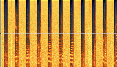

Looks like a file based corruption to me. Attached is an image of the visual of what audio content is in the file. Best to take it up with the manufacturer.
Andrew

Reckon that if it was an interference signal it would look very different as your 'interference' is completely blocking out all other audio for its duration. Hard to know for sure.
Andrew

Just looked at the image Andrew posted. Wow - this is a mess. It's so totally regular it surprises me.

I've measured the distance between the first sample in each noise burst. (Not through the entire file, but through several successive bursts near the beginning of the file.
In each case, the distance between the start of the bursts is exactly 65536 samples. That's exactly 2^16. So it appears to be some addressing issue. Whether it was a card failure, failure of the recorder, or what happened, I won't speculate. But this was not noise or interference that infiltrated the recorder and get recorded in any way. It's a data failure for sure.
