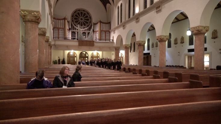

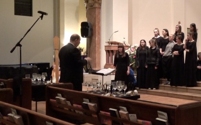

The mic can be seen better in this picture but in the original picture (post #1) it wasn't as apparent.
Second picture: view toward rear of church during practice, AX100 set up next to organ

On factor in the recent photo is the choir is arranged in an arc (near semicircle) with the mic at the center. This helps equalize the volume of each singer. With a linear chorus arrangement the singers at the edge are further away, and thus weaker. Not an issue for the audience, but it is for a single point mic.
As long as the listening is in stereo the comb effect of spaced mics is not an issue. A wide stereo image if widely spaced mics (according to the 1:3 rule, is not all bad, and helps with the issue of a long linear chorus.
I agree that the coloration and any mismatch of the AKGs would not be significant in the grand scheme of things. It would take a golden ear in a studio recording environment to notice. Try them some time when you have a chance in a practice shoot. You have what, 11 months, to sort it out before the next December concert.

I liked the curved layout of choir and the acoustic panels.
After watching the video I wound up watching well over an hour of various other choral groups. It was interesting to see how their mic(k)ing setups were and their layouts. In the end I wound up watching one titled (I think) "Vienna Christmas 2008" which was absolutely awesome!!! Everything about it - the singing, the orchestra, the setting, videography, ... was really nice. What a difference between the old buildings then and the new ones today. Sure, the new ones have acoustics aided by computer input but the beauty of the old buildings is really nice.
Talk about mics, they had a lot of them. Tried to read the name on one but my screen resolution wasn't quite there.
