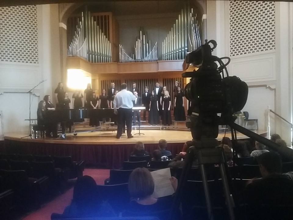

This has been a fascinating thread and many thanks to all of the links. I have been trying to take audio recording more seriously lately. The problem that I deal with is that these choir festivals tend to have choirs of all different sizes and there are no breaks between choirs to make adjustments, so I have to make a good middle of the road effort on mic placement. I have typically just used a matched pair of Rode NT3s on stands that are set up about 20 feet apart. However I have been thinking of adding another pair to the setup using an X/Y configuration in the middle and then having the other two further out. (I have been advised to angle the outer pair more directly at the edges of the choirs to avoid overlapping with the X/Y setup). This makes sense to me, but I was going to ask what others thought about having a 4 mic set up with:
a) choirs of different sizes/shapes and no time to re-position mics
b) a piano sitting there on the stage just off set from the middle
c) Do not have any 20' booms. (Just 4x K&M extended boom stands)
The problem that I foresee with the X/Y pair is the piano sitting there, upstage. Relatively speaking, the room is so narrow, that maybe I'm better off with just the one pair of mics? I have attached pics of the space. Thanks for any advice!

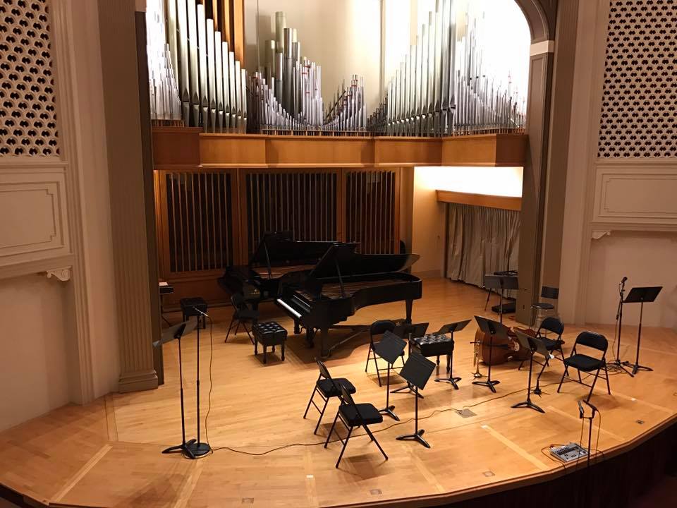

Another picture that shows where the piano is placed.

I use M/S rather than X/Y for most concerts - so far I've had absolutely no problem with a single coincident pair covering an orchestra of 60 - 70 musicians.I suspect if I were trying to record a space like Radio City Music Hall I might need more. I sort of rely on the fact that the conductor will manage things so the music sounds right at his/her location, so the closer you can get to the condutor, the better.
Old January 27th, 2018, 05:47 AM   #56
Location: Cornsay Durham UK
Posts: 1,992
Re: Audio Micing Church Choir
I agree that an M/S mic is a good simple choice and I have done numerous concerts using a basic set-up of a Sony ECM MS-907 or 957 straight into a canon HF11 camera as a locked off wide shot and using the small camera as an audio recorder. I have also used both mics and an old mini disc recorder for lots of TV sound capture and recording.
The advantage of the Sony mics is that they are M/S capsule wise but then output an A/B signal for recording, you can also adjust the width on the mic.
