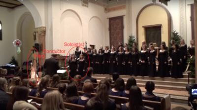

Here’s another Audio gig question.
This Friday there will be a girl’s choir performance in a church and I’m looking for suggestions on how to record the audio.
The gear available include Sennheiser ME64, ME66 (but only one K6 capsule so it is one mic or the other), AKG C414 XLS (gold with the “bump”), AKG C414 XLII. The recorder is a Tascam DR-44WL (stereo).
There are plenty of stands and cables. This will be a multicam shoot with the potential for up to four cams but we’ll probably only use a max of two and maybe three. Currently thinking of a wide (probably a wide angle but maybe at the rear), one for soloists, and one for the harpist.
The church interior is tall, somewhat narrow, but quite long compared to the width, with openings on each side. I’ve never been there so I don’t know the dimensions.
So, one more thing, this is not a BBC documentary and not looking for the ultimate audio job but want to get something better than in the past which was just using a H4n by itself.
Would like to have the mic(s) and stands as incognito as possible. We can probably put a mic about 10 feet in front of the choir as this was done once before, but I don’t know how high (I know it’s nice to have it high).
So the big question is, what do the audio guru’s think?
Mic choice(s)?
Options?
Mic the harpist or soloists separately (I think the soloist(s) might be backed up a bit by the choir)?
Concerns?

Lots of options to consider. If there is a rehearsal, try be there to run some test to see what works best for you, recognizing it will not have any audience noise/effects.
Some issues from the photo:
The ensemble is spread out in a line over a wide area. Makes balanced pickup by a single point mic difficult due to varing distance from the singers. An arc would be a better arrangement to keep all voices about the same distance from the mic.
The conductor appears to be almost back to the first row of pews. A mic placed behind him may pick up more audience noise than you want. Also, the further the mic is from the direct sound source (vocalists) the greater the impact of venue reverb, and the conductor is a good distance from the singers.
The two mics in the $199 DR-44 may, or may not, be better matched than the $950 C414s whose published curves appear to be within 2 dB. Be sure to evaluate that in your tests.

This is depressing and not the outcome I had hoped for.
As I read the comments above from learned and esteemed members, it appears the consensus, if I’m getting it right, seems to be to use one of the recorders built-in mics to record the choir. Is that correct?
If so, this is not the outcome I anticipated or hoped for which was to make use of the recorders using the good mics.
What concerns me is:
(1) the quality of the recorders h4n and Tascam built-in mics (or lack of thereof, compared to others available), and
(2) the distance of the recorder from the choir. Given the distance behind the conductor (I’d estimate about 20 feet to the front row) wouldn’t the recording sound very flat and shallow, or thin?
If the choir ties up one of the recorders then there is only one left, so what to do with it? Capture the soloist(s) and the harp? We might be able to run a cable along the foot of the bottom step between the soloist(s) mic and the harp’s mic. That could work.
Are there any other possible options with the kit we have?
Would it be better if the conductor was closer to the choir? If so, I could ask.
More info: There is no organ and no PA system involved.

Lost everything on the post I had just written and have to start over again. This time it will be the short form.
More info: The songs they’re singing are mostly out of the 1400s and 1500s and not the popular songs of today (f.e., Jingle Bells, White Christmas, etc.). The sound of the songs, including the ambience, is like one would envision from some old convent, monastery, or abbey way back in the day, complete with all the natural reverb.
And it is a concert, not a stage play. The church has a really really high ceiling, maybe 40 to 50 feet, and there is no balcony.
