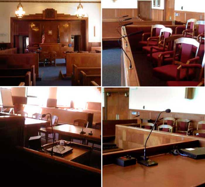

Many modern courtrooms use audio (and video) recording instead of (or in addition to) a court stenographer. It is not uncommon to see gooseneck microphones especially on the witness and the judge for purposes of recording. The jury has no speaking parts. But the attorneys are the wild cards and may wander all over the place, but often speak from their respective tables. I would put wireless on the attorneys if they are wandering around. OTOH, for arraignment or preliminary hearings, they are often shown with the opposing counsel standing at podiums facing the judge.

Courtroom mics are not for amplification, they are for the monitor who is recording it to to maintain the record of the proceedings. Podium/table mics are the most feasible solution for that situation, they’re not intended for anything of quality that would be used in cinema.

True, but Ryan's "cinema quality audio" ship sailed weeks ago. We seem to be trying to discover the "least horrible" way of capturing dialog with limited resources. Although, if he has already recorded "wet" dialog track, that ship has already sailed as well.
