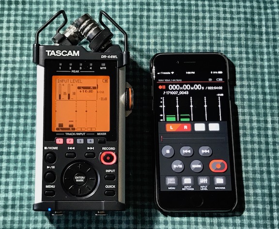

Given the somewhat difficult working conditions that has been presented it would be handy to have more options available, like a safety track for example. Sure, the discussion has turned to splitters but just want to give a plug for the safety track because I think it would be really handy.
Speaking of handy, how about another recorder? While everyone has their preference, this Tascam DR44-WL has worked very nicely for me. Has two stereo inputs, records safety tracks, and is easily controlled with a smartphone. As I write this, eBay currently has a used one for Buy-it-Now open box US$193.30 or new for $205 (free shipping).
[Edit: forgot to mention, it can be operated from a distance via a smartphone application (iPhone in this case). Works well it in combination with a plant mic. Operate Start/Stop, gain adjustment remotely]
With a second recorder one can record the plant mic, hook up a lavaliere, or what have you.
Can’t have too much kit!
Should I be using multiple mics to record dialogue and sound effects?-img_2387-2.jpg
