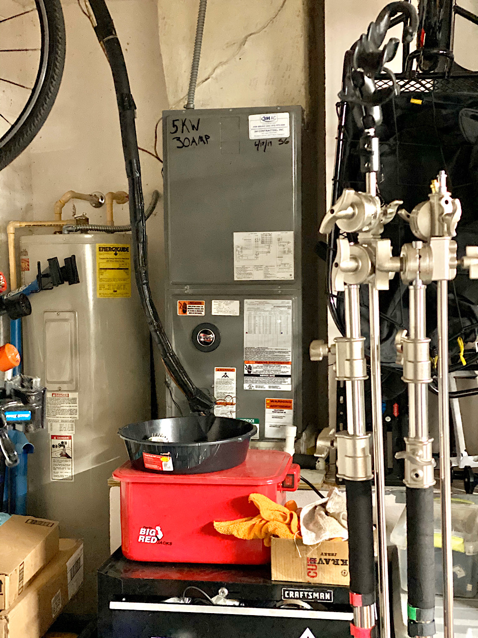

A/C Unit in the corner.

As for the A/C unit in the far corner, I typically shut it down during shooting, but here in Florida, I can only shut it down for very short periods, or the house will get so hot that it can't catch up for the rest of the day.
While shooting in the winter is better, I am limited to 10-15 minute shoots then have to break for 30-45 to let the A/C catch back up. Side note: the A/C system was replaced this past summer, which helps, but still is a problem.
I want some suggestions for dampening the sound. It is loud raw, but it's steady and relatively easy to remove in post. I would, however, like to knock it down some so that it's not as distracting.

Some A/C units might allow a lower fan speed, which generally will not be as noisy. If the main source of sound is the air intake and/or discharge you might be able to build a baffle to silence it a bit.

A solution would include:
- Building a double-wall utility closet around the HVAC and use sound proofed duct work to feed the main space.
- If practicable use lower speed blower (faster air movement means more noise)

It would be helpful to know more about the HVAC system. There are no air ducts shown. Is it, or the water heater (?) next to the HVAC, gas fired?

The suggestion about walling off the noise culprits is a good one and would be worth pursuing. One way to investigate the ins-and-outs of putting a wall around the units would be to talk to a few HVAC businesses about how that can be done, and at the same time find out about any building code issues. With regard to building codes, the cite such as which Code (NEC, NFPA, UBC, etc) and, if possible, the sections, would be very helpful. At that point, though, they would probably suggest talking with an architect ($).
The local building department jurisdiction would have a permit fee schedule on-line.
If air vents are required, such as for a gas system, then they could be baffled or the air supply vented to the outside through the wall or ceiling.
A wall would be more work and expensive than mic placement but if the latter isn't enough then it's an alternative worth investigating.

If you decide to wall off a noise source there is an adhesive for sheetrock that helps minimize sound transmission. If nailed to studs the noise is transmitted through the studs. Insulation also helps. This is the article referred to earlier. https://www.gearslutz.com/board/stud...look-here.html

The typical technique is to use staggered studs one set for the inside wall, the other set offset a bit for the outside wall so the motion of one wall is not is not coupled to the other though a common stud. And insulate the dead space between the walls. Adds a few dollars and an inch or two to wall thickness but is effective.
It looks like an electric hot water heater, and a Rudd heat pump (with 5KW electric coil booster heat) - very common configuration in FL.. The main noise would likely be the blower and perhaps the heat pump outside the garage.
