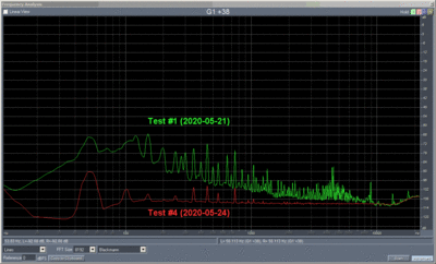

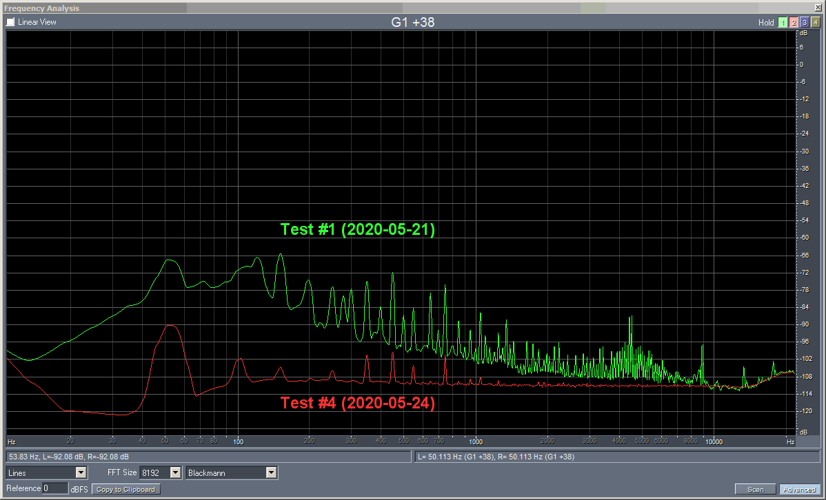

Paul, I completely agree with that assessment. And this is a very strange puzzle to solve! Different USB cable did not change a thing.
The attachment shows how much lower the noise is when the mic is unplugged.
What to try next? Turn on exactly the same kit, record silence, move the mic and cable around. Exactly as Paul Johnson suggested. Does the hum change in loudness or in character?
One other test would be to leave the cable connected to the mic. Unplug the cable from the dBx, plug it back into the M-Audio, and record another test (voice + silence) using the M-Audio. While recording the silence part of that test, turn the dBx power on and off, see whether the hum is related to the dBx being turned on (even 'though it's out of the circuit).
One almost gets the impression that there is a tiny source of audible hum in the booth which is actually being picked up by the mic ... a chorus of tiny mosquitoes with perfect pitch ... but of course the OP would have said "I hear the same hum in the booth, with my ears."
There's also the possibility of a corroded connector, putting more resistance in one side of the circuit than the other. This would probably be either the mic end of the cable, or the mic connector itself. Some good spray contact cleaner (Cramolin or Deoxit), Q-Tips, and pipe cleaners would identify that.
And there's a possibility that the power supply in the dBx is bad. Yet the recorded hum goes away when the mic is unplugged, so it's a very strange kind of fault.
Unfortunately, Paul (M), it looks as if you're in line for a few more tests. ;-) We have to be getting very close now. Good luck!
