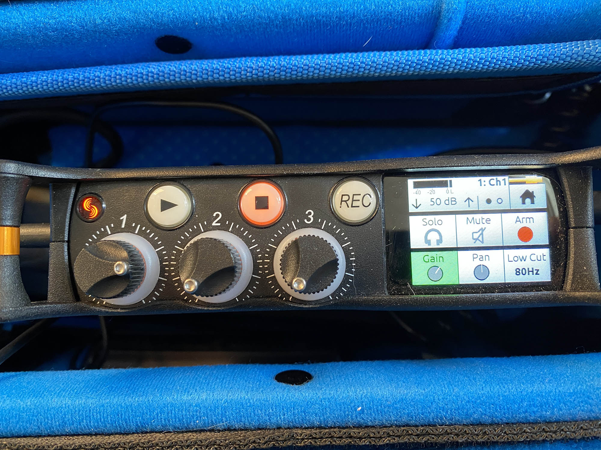

Can you explain more how to do this? What do you mean by fader at 12 position? Here is a photo of my recorder. What should the fader be set to on my recorder?

12 (o'clock) on a channel fader is usually "unity gain", unless specified or marked otherwise..

Originally Posted by Pete Cofrancesco View Post
A very simple answer set gain so you're peaking -18db to -6db with fader at 12 position. This allows plenty of headroom so you won't clip. In post you can adjust it to your liking. The amount of headroom varies based on what you are recording. All of this assumes you have proper mic to subject distance. If you have a dynamic mic 6ft away then increasing the gain to achieve proper levels, you'll end up with a lot of noise.
Originally Posted by Rick Reineke View Post
12 (o'clock) on a fader is usually "unity gain", unless marked otherwise.
So set it to roughly where the number 1 is written and then adjust the input gain?
Kathy Smith is offline   Reply With Quote
Old November 27th, 2021, 04:44 PM   #9
Join Date: May 2004
Location: USA
Posts: 3,012
Re: Input gain and preamp
Yes. When the fader is in the middle (12 o'clock) you have room to adjust the levels up or down while recording.
