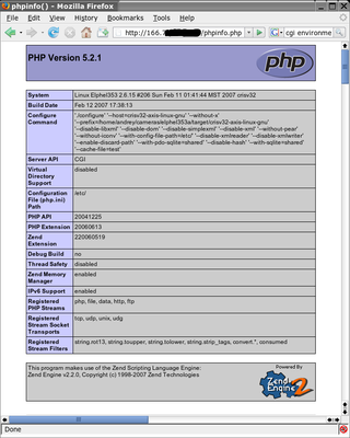

PHP in 353
I hope it can make development of the camera interface easier - PHP now works in the 353
Andrey Filippov is offline

cool I tink is possible to use it to make a database to save the setting
and to load preset ....did you suggest some more spec that can be used with this new capability (php rocks)?

Matteo, there is no database (yet) - just php itself to simplify server(camera)-side interface software. I'm thinking of a number of smaller binaries (instead iof the ccam.cgi) for low-level hardware-related functions with the interface level implemented in PHP.

Php...
Andrey,
PHP in-camera - very cool...
..would it be possible to start a in-camera timer that executes a PHP script say every 5minutes or something...taking a photo or doing something else?
Just curious
//O.
