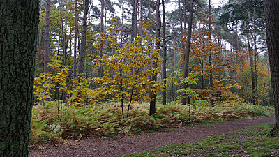

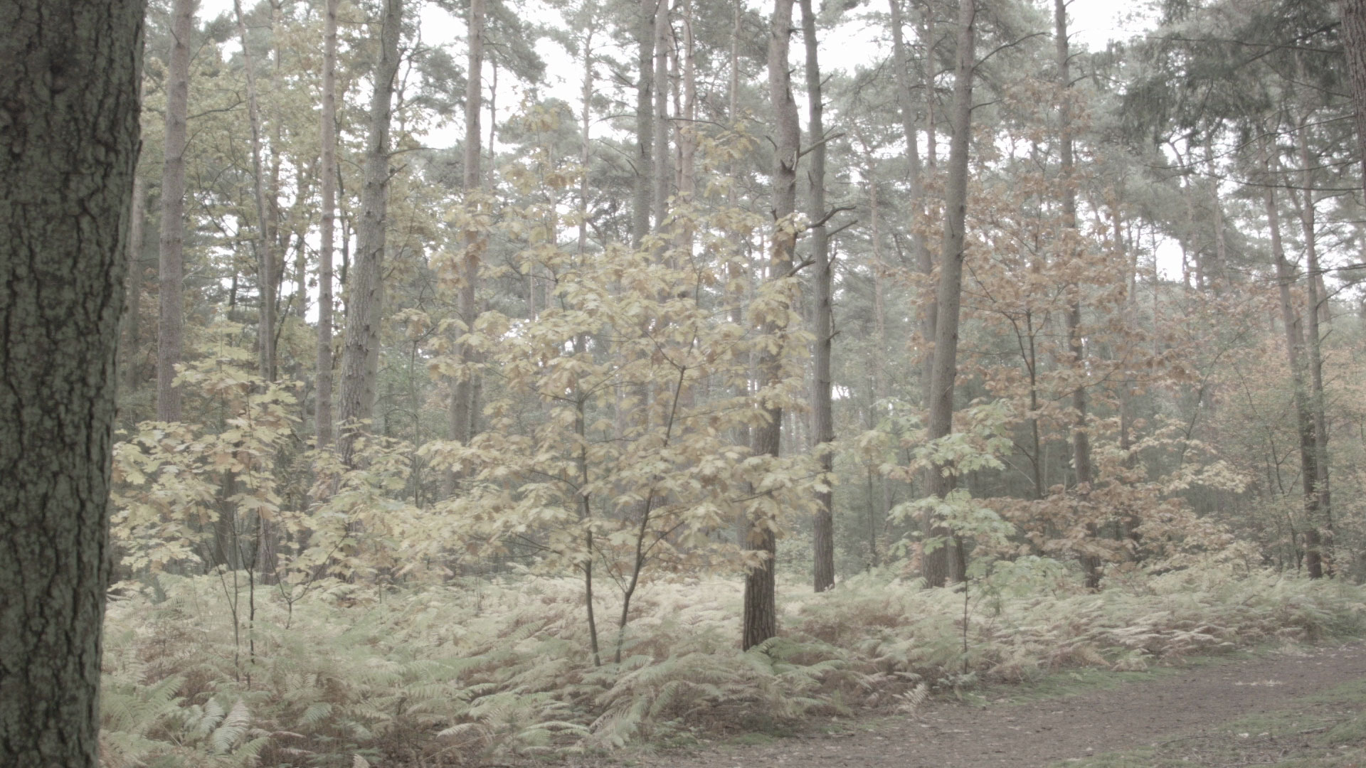

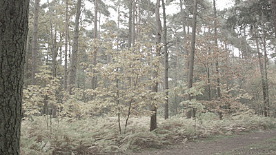

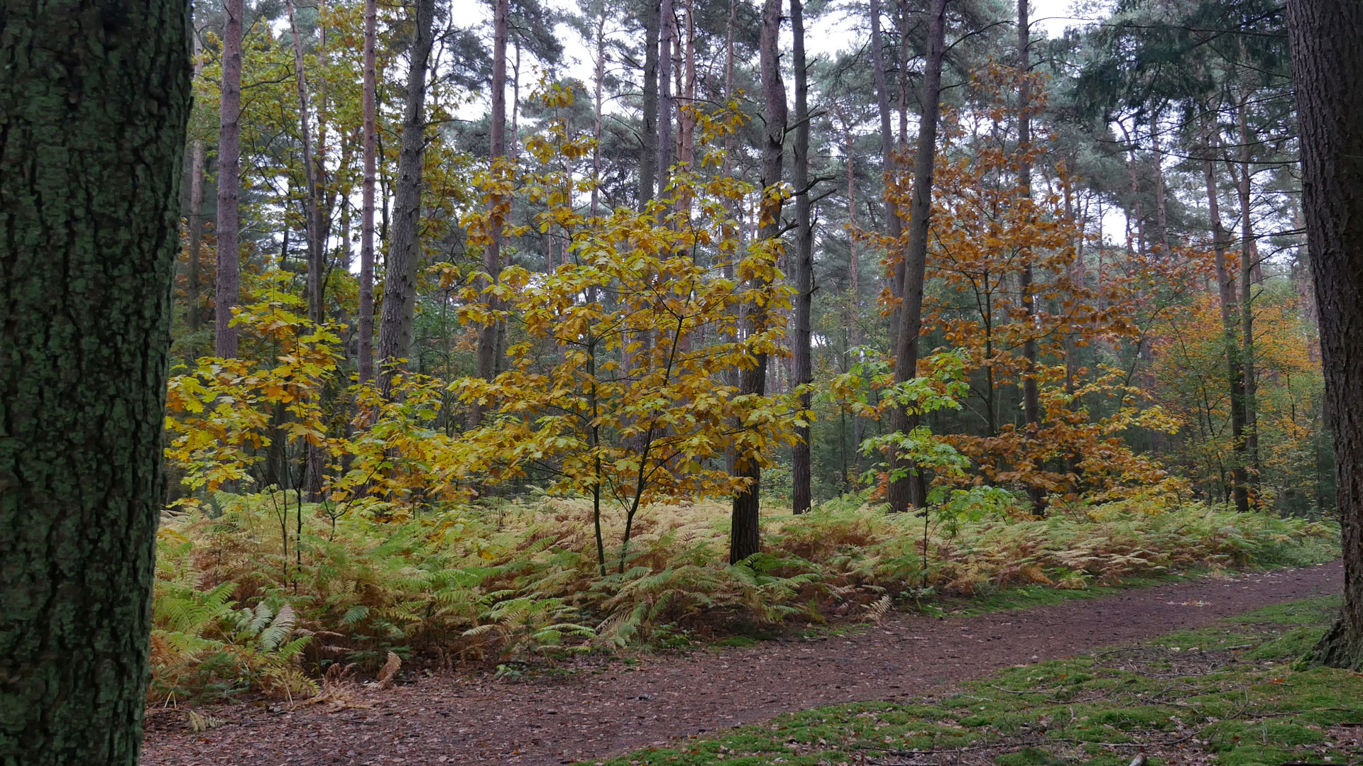

Thx for the links Craig but I wanted to know how you colorcorrect bmpcc prores to make it look like reality. Like below frames where one is from the bmpcc in prores and the other from the gh4. I have a hard time even getting any color into prores while in raw it's very easy.

Hi Noa
Wow - I'd like to help. If I could download a few frames of the ProRes I'll bring it up in Resolve tomorrow evening (my clients are here from Tokyo until mid afternoon so can't work on it until late in the day) and have a shot at a basic CC and (assuming I get something reasonable) I'll walk you through exactly how I got it.
First impression is that your PreRes image looks like a good starting point - my stuff looks like that before I grade it. In fact I want it to look like that for starters.

Thx Jim, I do have resolve 12, the free version, on my pc but during install I already got the message that my pc was underpowered, probably because of my quadro k420 card which doesn't meet min specs but since edius doesn't require a fast graphics card I don't intend to invest in a expensive one just for resolve. But I can get it to open.
What I find so difficult with these bmpcc prores files is that you don't have any reference at all what the color looked like to start with, every attempt I did so far just resulted in very weird looking colors. Otoh V-log from the gh4 looks even more flat yet I can much easier get accurate color out of that one in Edius.
Below are 4 very short prores HQ422 clips straight from the card, They all where just testshots and I have identical GH4 shots as a reference. If anyone wants to have some fun and see what they can do with these, be my guest to download and play with them. Ideally I just want to colorcorrect in Edius but I"m not able to get any real and especially no accurate color out of it. Just to make myself clear, I"m not saying that Bmpcc prores files cannot be colorcorrected, I just don't know how.

I did a quick grading with FCPX of your first 2 Clips. Shortened to 6 sec. each to save time.
In both shots the sky is completely blown out on my waveform monitor (cliping at 100 IRE) so there's no color in there. For some reason, there appear to be not enough metadata in your clips to allow FCPX to automatically process the "Film" mode of the clips into the standard Rec.709 gamma profile for viewing. So I just did it manually.
First shot may look slightly warm compared to your framegrab. Is it closer to what you saw in the actual scene?

Yes, this looks close to reality, what exactly did you change it fcpx?

I can't remember the exact number (degrees of adjustments) but here is roughly what I did:
- bringing down the shadows but not to exceed 0 IRE
- bringing down the midtones, by guessing to the level that looked "pleasant" to me.
- not touching the highlights since most of them already clipped at exactly 100 IRE, raising them would have clipped parts of them that were not yet clipped but near the threshold, lowering them would have made the scenes look murky or too flatly dull without gaining any more color or detail in those parts.
- raising the global color saturation to the max and raising the midtone saturation to about 2/3 the maximum. Both adjustments didn't affect the sky which had been clipped to completely white.
- not altering the color balance of the clips as I had no idea what the scenes actually looked like.
I believe you can do the same in your PC-based NLE as the above is very fundamental to level and color adjustments but the hard part is the subjective things as personal preference for color, contrast level, and sharpening level, etc. Some NLEs out there should be like FCPX in that they can recognize the raw files (BMPCC ProRes, Sony S-log 2/3 XAVC(S) etc.) uploaded into the programs and do automatic mapping of the files to the broadcast standard Rec.709 looks. from there you only have to do some minor adjustments as you like.

I played around a bit with the jpg image (which is probably an exercise in frustration after it's been through the jpg compression)
What kind of day was it? The feeling I get from fooling with the jpg and looking at the blown white sky is that it was a bit overcast and not very highly saturated or contrasty.

Weird, I"m on win 7 pro and use edius 8 workgroup. Also, it was a overcast day, the overexposed parts you see are clouds only.
