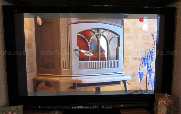

Old March 3rd, 2010, 02:09 PM   #41
Posts: 27,382
Compare these two images (click to embiggen). The first is the live HDMI output. Hopefully you can see how it's slightly windowed, plus there's the red recording icon. The second is the actual HDMI playback, which fills the screen as you'd expect. The overall wonkiness is due to the wide-angle lens of my little point & shoot digicam.
HD-Out over HDMI while recording-hdmi1.jpg   HD-Out over HDMI while recording-hdmi2.jpg
