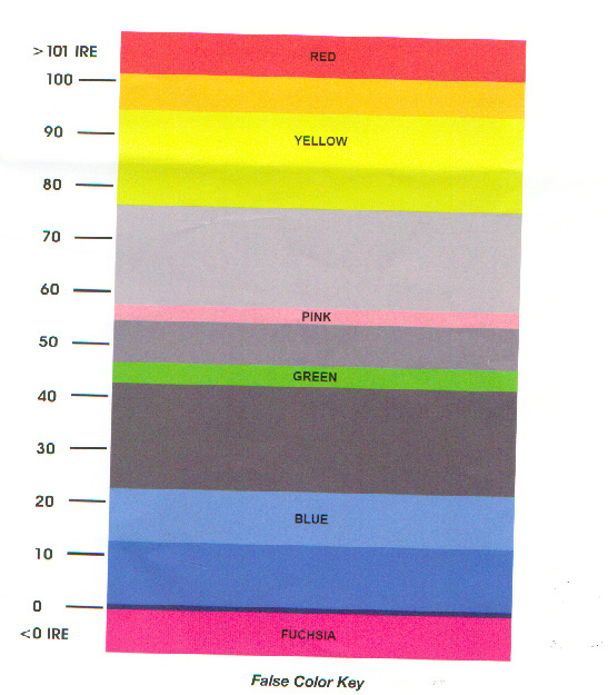

Originally Posted by Russ Ivey View Post
Chris, can you elaborate on what you mean by "false colors"? What does this feature do exactly and what does it show?
Russ, sorry I missed your query earlier.
False colors is another way of judging proper exposure. Advanced monitors and cameras have this feature. I first ran into on my Marshall monitor, and found it resolve a lot problems with trying to guess how the image was going to be exposed. Essentially it converts the image into zones of lighting that tell you what a particular part of the image is being exposed at in IRE.
The zones break down as shown on the attached chart. I understand that you want your lighter faces to come in around 55 to 60. You want to keep your images out the red because of clipping, and also out of fushcia to avoid loss of shadow detail.
While in ML and using movie mode, you just have to press and hold the flash button on the top left of the prism housing.

False colors
Follow up on False Colors:
In the first addition of false colors, in order to get proper false color readings, we were told we had to press the play back button once. Then exit. I thought that had been fixed but it appears not. So after staring ML, and before actually using, just hit the play button (>) once and exit it, and your false colors will be a go for the session.
