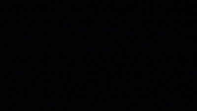

I took some video with the lens cap on, as it's more noticeable the darker the screen is. Here is the screen shot.
To my horror, I discovered not only the original culprit, but also many many others... not as luminous, some more purples and a few faded reds.
I tried the "clean now" setting. It said it was cleaning the sensor, then took me back to the menu. I'm having card issues now... I will inspect the footage as soon as possible.

Correct me if I'm wrong, but isn't that just noise that you're seeing in that picture?. Canon 7D ISO versus noise test images Marvelsfilm’s Blog

Well, I'd feel mighty foolish if that were the case. But I don't believe it is. There is some noise in the image as well, but I am concerned about the small bright purple square in the bottom of the frame, near the center but slightly to the left. I called Canon with the issue, they're recommending that I ship to them for repair.
