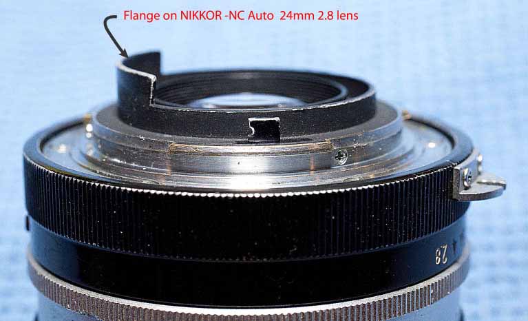

There's nothing wrong with your adapter. THe technology of these are very simple, just machining and the Kawas are well machined and snug fitting (and forget about the ridiculous shipping comment...that's how they make a little profit - it's simply a $15 adapter, and a fraction of the competition)
So, the 50mm 1.4 has been rumored to have a mirror issue, but because this all relatively new and there isn't enough consensus and because I wasn't about to ruin a new 5DII with a $200 lens, I grabbed a file and took precautionary measures.
If you look at one of the metal tabs on the 50mm 1.4 compared to a number of other Nikon primes, there is, in fact, an additional level to the mount where this tab protrudes beyond the mount (it would be the same with any adapter).
I covered the back glass with a cloth and used a pair of snips to clip it and then quickly filed it smooth (I'm no machinist so you know it''s easy) and in maybe 5 minutes it was all set to go.
I actually tried one of the AF confirm chips for a few bucks more on this and it works great for still work. The autofocus point lights up and you get the audible beep when you attain focus...very important wide open with a 1.4 lens.
Crazy world - a few dollars worth of adapters and Nikons now rule for Canons.

Jim
Thanks for the info
I looked at one of the Nikon lenses and in fact there was a tab that protruded beyond the adapter.
Hoping to attach an image showing the tab
Will chop it off and see if it works
Best
Jay
