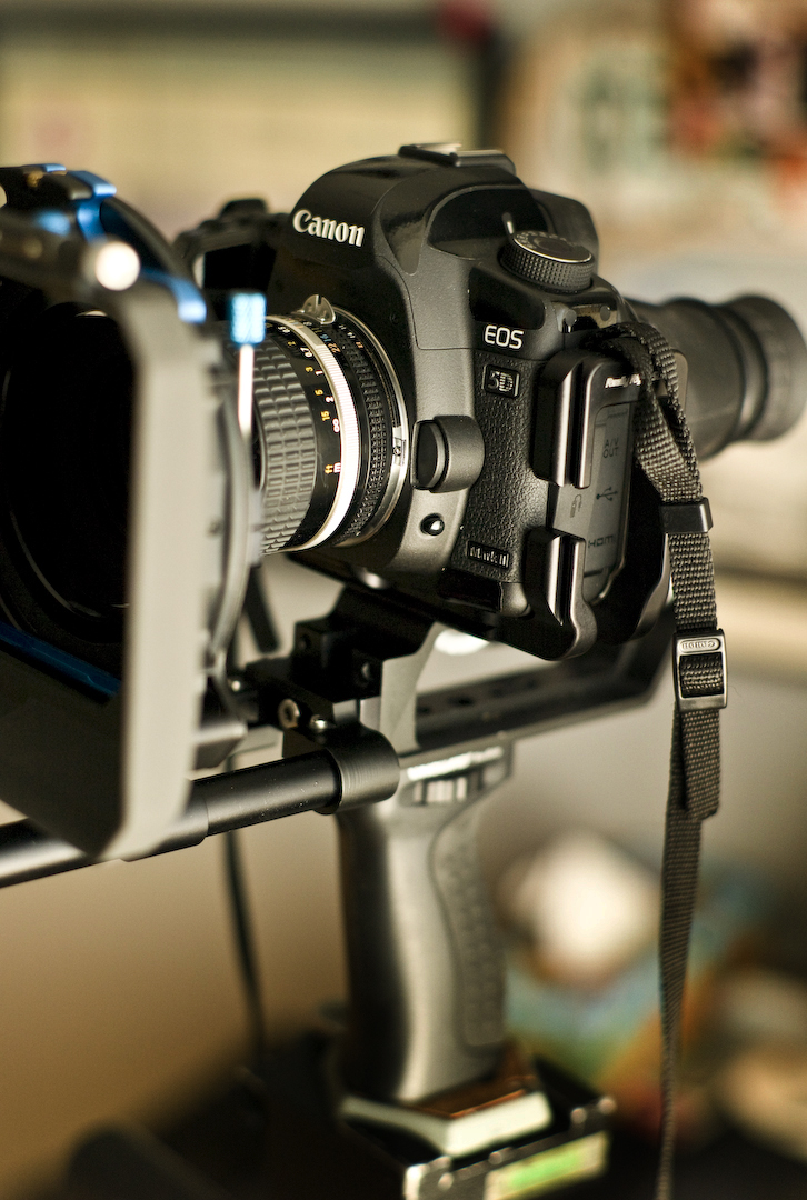

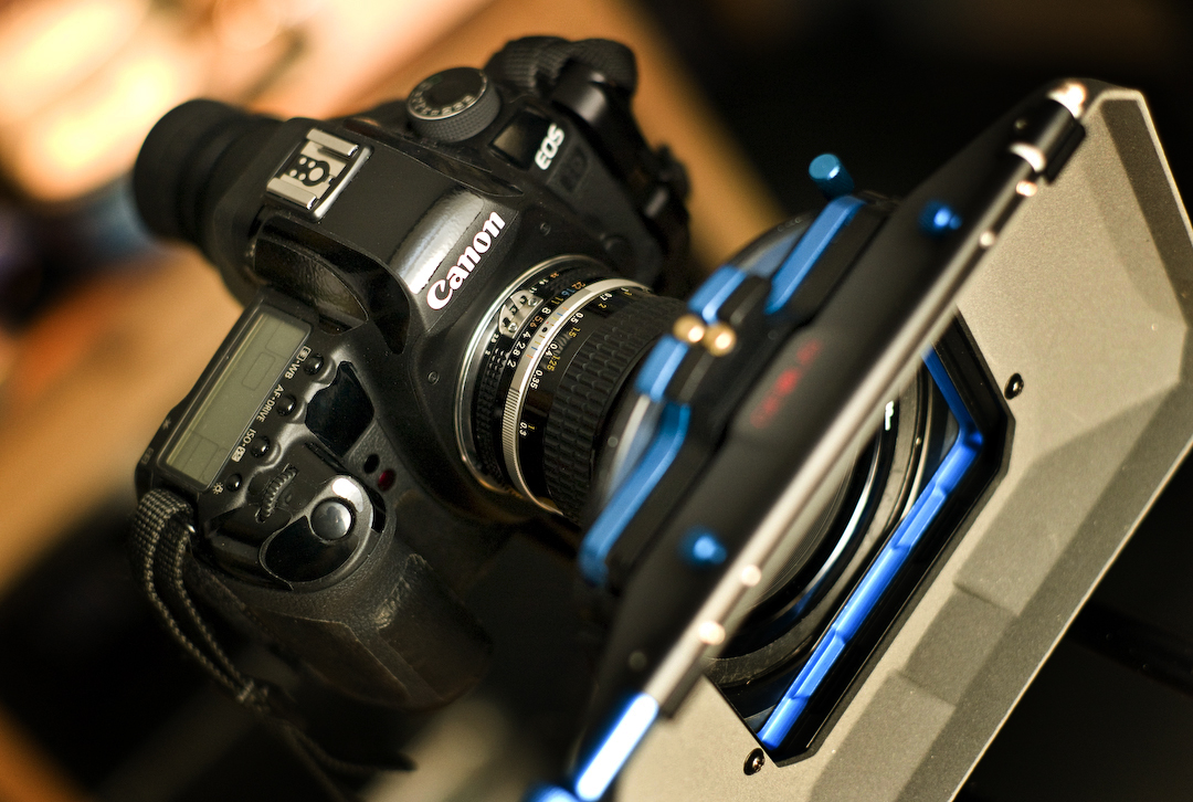

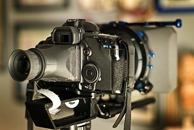

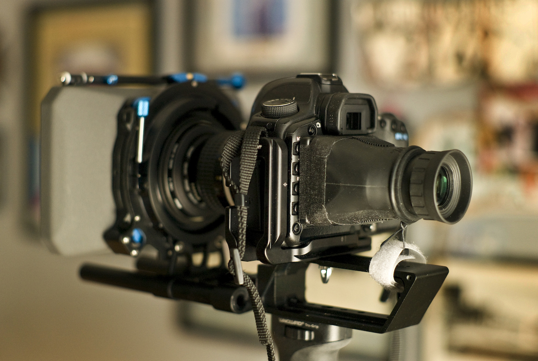

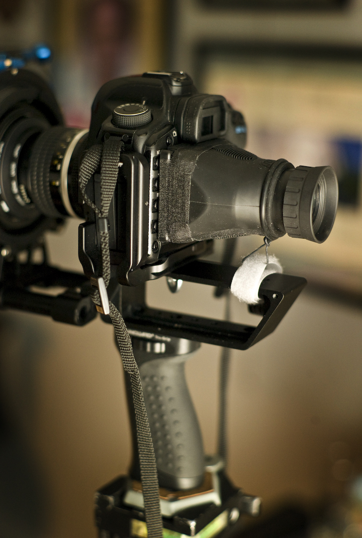

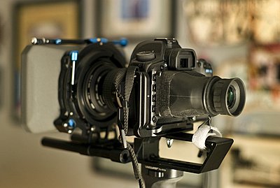

more CAMERA PORN...
Well, I could not resist... Some time to kill, and I finally got the Hoodman 3" viewer and LCD frame/shade for 40D. A little elbow grease, filling and gaffers tape: I have perfect "direct view" on 5D Mark II. I got all adapters for Nikon primes, so now there is no light leaks on the matte box. Enjoy the camera porn...
Steven S. Miric is offline   Reply With Quote

Steven,
Congrats, glad you like the Hoodman setup. Maybe we should go into production!

Very nice, indeed -- but Stevie, will a follow focus work on that setup... if so, what are your plans?
-- peer (who's still on the fence until the xl2 is sold)
For FF, I will add Manfrotto 357 sliding plate to gain extra room on rails for the big know and gear. I will do that once I get Redrock kit.... One thing at the time...
