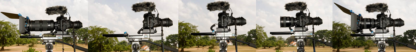

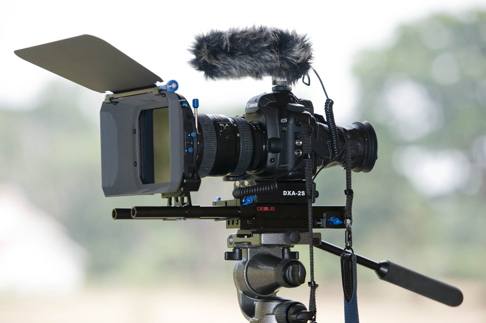

I've attached some pics of the new Genus wide angle mattebox I’ve been using on my latest trip. Genus It's low profile, light weight and wide angle coverage made it the only Mattebox I've found suitable for my style of run and gun shooting with the 5dmkII. As an added bonus is that it also works with my EX-1, EX-3 and broadcast lenses on my DSR-500. It has two aluminium filter stages which rotate and lock into place firmly and the whole thing looks as well built as possible for a lightweight product.
The best thing though is the Genus advanced adaptor bar system http://www.genustech.tv/userfiles/im...textendedl.jpg As you can see from the pictures it allows rapid extension of the bars to accommodate different lenses without having to change the rods, pure genius. It also gives you limited horizontal and vertical placement of the 15mm support rods. On the 5dmkII you can clip the lens onto the Mattebox too making a very secure setup.
Next I plan to devise a shoulder rig based around this and my existing Redrock Micro shoulder support system, although Genus say they are working on a solution too. I’ve also ordered the new Redrock Micro v2 follow focus microFollowFocus Complete Package which I’m hoping will work well with this rig. The other product I’d like to try with this is the Zacuto zwing-away Zwing-away adapter - Zacuto which would make changing lenses even quicker, but it is not cheap.
I've looked long and hard at Matteboxes before plumping for this one, my previous collection include the Cinevate, Formatt and Cinetactics offerings but none really worked well with the 5dmkII. I like the look of the Redrock Micromattebox but ruled it out for run and gun due to its size and weight. The Vocas mattebox looked nice but was expensive for the same config. I really like the Genus because I can finally use a Mattebox with my Nikon 17-35mm lens without cutoff for video (it cuts off with stills but not the 16x9 video crop) The only caveat is that you need to take the screw in skylight or UV filter off but then I'd do that anyway with a Mattebox. I bought the optional top flag which I think is essential, there is currently no option for side flags but for my shooting this is less of a concern. All in all it's the best Mattebox for my needs.

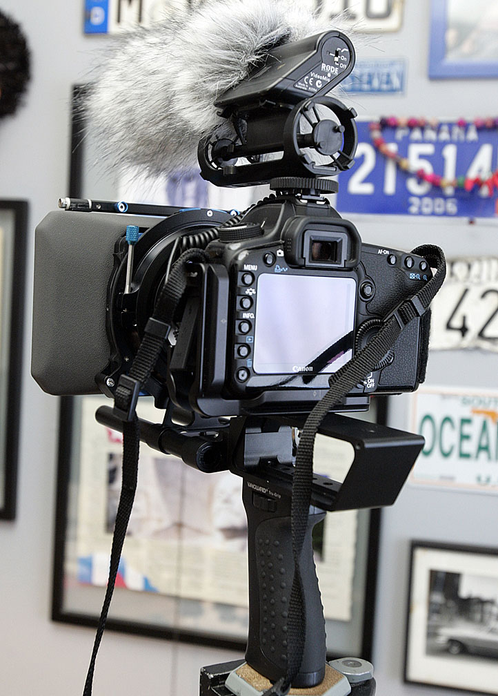

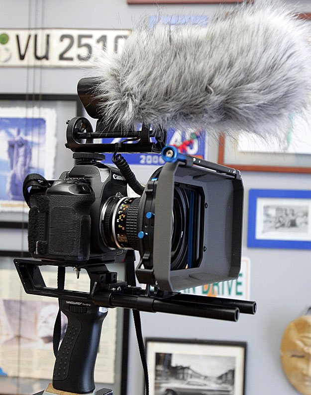

Here is where I came so far.
Some parts missing (step ring, Hoodman 3",follow focus,...). All in time... All part but the mic were already in the inventory from my EX1 kit.

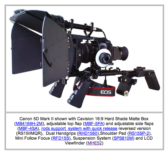

Cavision.com makes really good mattebox / railsystem etc.
Check them out.

I actually have some Cavision gear, including the shoulder support from your picture. Problem with the Cavision Mattebox is that it is just too cumbersome for my purposes, you really need to compare with the Genus to see how much lighter/more compact it is while still offering wide angle coverage. If I wasn't worried about the size and weight I'd say the Redrock Micro mattebox is better constructed and I'm pretty sure about the same price if not cheaper than the Cavision.
I do like the Cavision magnifier though, I wonder if they will bring out a 5dmkII version with some kind of attaching mechanism.

Steven, I'm curious to know how heavy your setup is when handheld. Have you yet shot long sessions with it handheld? To me, where the grip is located, it looks a bit forward balanced, or perhaps it's just the picture that gives that impression..?
