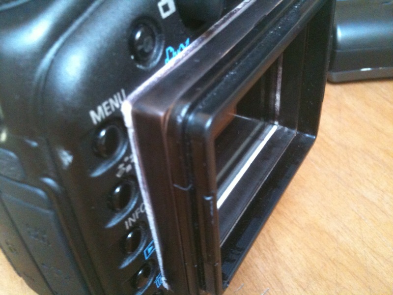

They are suppose to come out with thicker spacer, based on my feedback. The spacer I made is 6mm thick with the addition of double stick foam tape that is apox 1 1/2 mm thick, making a total thickness of 7.5mm. I still have the focus ring all the way out. I think you would be best to go to a total thickness of 12.7mm or 1/2 inch.
It is a thick mount attached to the camera, I would like to see a 3rd generation of Zacutto Z finder with a longer viewer, or even interchangeable optical elements without the thicker plate attached to the camera.
The spacer does protect the LCD from the potential of scratches, since it is now in it's own well. I just ordered a new LCD protector from Canon and the double stick tape that affixes it to the camera. Removal of the LCD protector may be the most challenging.
I am sure when I remove the spacer I made that it will pull off the Canon LCD. I do have a small scratch on it now and I will document a "HOW TO" at some point in time.
