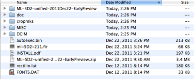

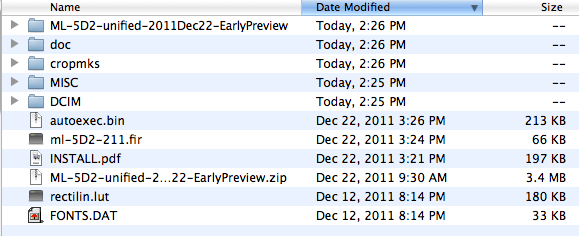

Re: Magic Lantern Install Advice please
Not to change subjects but, well, to put this thread back on topic:
I followed the instructions from Ted and the Wiki and I don't get the confirmation screen that the install instructions say I should see here: Unified/Install - Magic Lantern Firmware Wiki
After doing the firmware update with all the files from the ML Unified zip file in the root of the card, the Camera boots quickly into the Canon Firmware. It says the FW level is 2.1.1-ml. If I restart the camera, it reverts to Canon 2.1.1.
I'm not sure what to do at this point. Any suggestions? TIA

These are the files on the 1GB San Disk CF card.

This problem was resolved thanks to Ted. There's a step in the instructions where you Clear Settings. While seemingly innocuous, it is apparently critical. Also, once the camera boots up with ML, one must press the Trash Can icon to get the ML menus.
