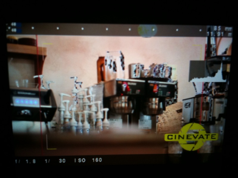

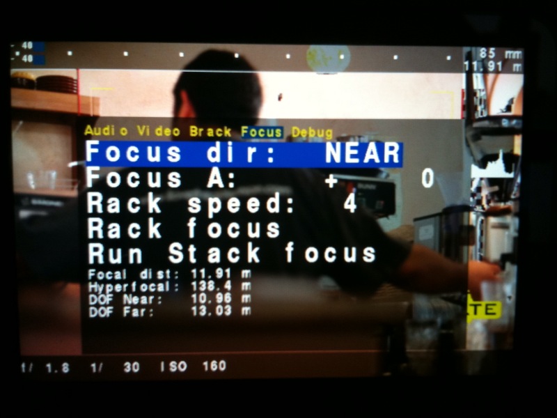

After a month of development and testing, Magic Lantern 0.1.6 is finally ready! Some of the new features:
* Custom cropmarks bitmap file
* Live histogram while recording
* Time remaining estimate indicator
* Automated focus pulls
* Focus stacking
* HDR exposure bracketing
* Lens data (hyperfocal distance, DOF, etc)
* Cleaner, multi-level menus that timeout automatically
* Audio monitoring can be turned off during clip review
* Internal mic can be used (must enable audio.mic-power=1 in config)
* Output audio volume control
* Configuration can be saved into magiclantern.cfg
It is still beta, but lots of usability bugs have been fixed since the 0.1.5 release. There is new documentation being written and new cropmarks files will be available soon.
As before, please review the Frequently Asked Questions. Bug reports can be entered in the issue tracker.
Good luck!

Focus Rack?
Firstly - amazing work. I can't express enough how incredible it is to have ML as a resource!
I saw Chris' 0.1.6 manual go up yesterday, and was excited to find the firmware today - so far so good - I've already setup a custom 16x9 cropmark, and been playing with the new settings.
One main question - I can't seem to activate the 'rack focus' feature - I'm able to set 'near' and 'far' points, and I've chosen the 'Rack Focus' option and hit the joystick button - but nada. Is it possible (or maybe it's already there) to activate this via a button while recording?
thanks again!

Andy:
Give out some particular of what you are shooting with, includings lenses, and how you are setting things up. All this will be necessary information as this is test tested further. Remember, this is Beta, which means we are all second level testing it and information will be greatly appreciated.
Sure -
5dM2 with Canon 1.1.0 Firmware
50mm 1.4
Magic Lantern 0.1.6
In the Focus menu, I chose "FAR",
Moved down a line to the "FOCUS A" Focused to the FAR point, and pushed the joystick in (also tried the SET button)
Left the RACK SPEED at default (also tried different values)
Focused the lens to a near point, and chose the RACK FOCUS line and hit the joystick button - to no effect.
Did try the FOCUS STACKING - that worked like a charm!
I think that covers it...
andy
Andy Batt is offline   Reply With Quote
Old August 14th, 2009, 12:37 AM   #10
Location: Camas, WA, USA
Posts: 5,513
My son did a rack focus shot tonight as we prepare for a 48-hour weekend. We set up a dolly and track, he pushed forward as the focus racked, we reviewed it on an HD monitor, and he pretty much jumped for joy. He had done two similar shots manually for a short film last winter, they took forever to set up, he did many takes, and they didn't look nearly as good. :)
Here's the method:
1) Zoom in
2) Manually focus the lens to one of the targets. This is best with a FTMF (full time manual focus) lens. Set the lens to AF.
3) Press the picture style button for the ML menu and go to the focus menu
4) If you focused to the near object, set the menu to FAR. If focused near, set to FAR.
5) Press the zoom button momentarily. You will see the number of steps change. Press and release, until you get in focus. Note the number, in case you go too far.
6) If you go too far, you can reset the value to zero, exit the menu, and go back to step 1.
7) Once properly set up, activate Rack Focus and it should do its thing.
If you toggle back and forth, you'll likely build up some errors. Just exit the menu, refocus one of the focus points, enter the menu, leave the same number of steps as before, and do more takes. Just make sure to set the NEAR or FAR in the direction that you will take next.
