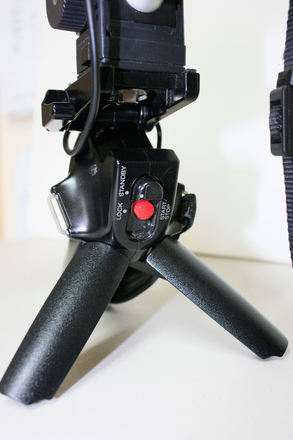

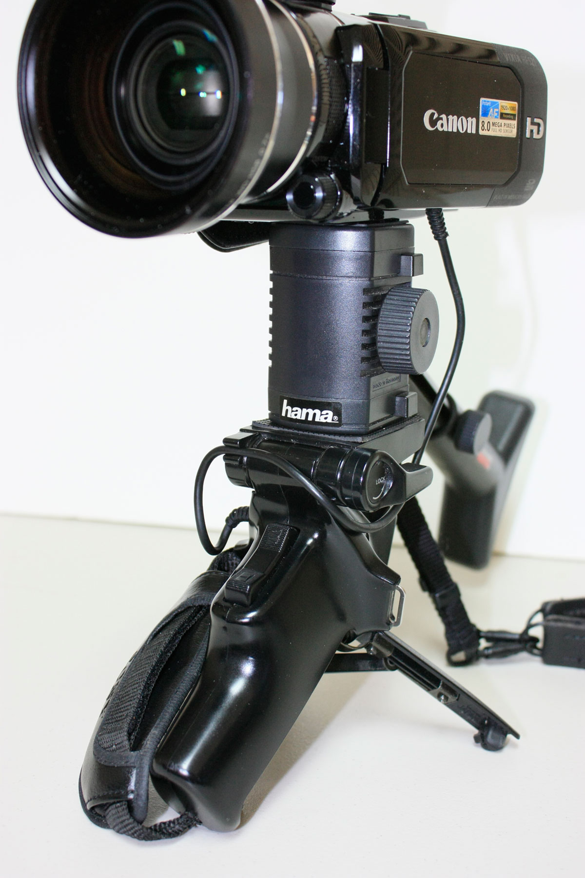

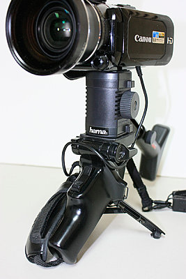

LANC remote control--------I was really waiting for this one. I have a very old pistol grip from the Video 8 Era from Sony that has a LANC cable that connects to the remote terminal, and allows me to do the basic: start/stop, zoom in/out, on/lock/stand by. operations all from a firm hand grip. The grip also converts to a rock solid small tripod that is invaluable for certain table top shots. (see attached Jpeg).

Hi Morane: Thanks for your interest, I think any Lanc control would work, there are several Varizoom, Manfrotto has several good units plus the basic Cano's ZR-1000 and the more expensive ZR-2000.
The Pistol grip with the Lanc control depicted in the Jpegs is over 15 yrs old and it works like a charm.
I wish they would start doing more practical accessories like these again.

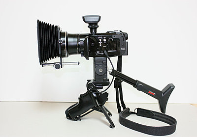

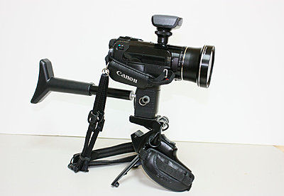

luis very nice setup..can u tell me is this raynox wide angle? and what type of matte box is this?

Hi John, thanks for your interest. No it is not the Raynox, it is Canon's wide angle adapter WD-H58 which also fits the S10. It is not a matte box but certainly it acts like one or a good lens shade.
It is a lens shade/bellows attachement of an old Hasselblad camera that I use to have. I had to do some machining to fit the posterior diameter to fit the outside of the wide angle adapter.
I am still working on a rubber or plastic lining so that it won't mar the outside surface of the barrel. It has a slot for gel filters to be placed between the lens and the shade. It works pretty cool.

In answer to your first question, Yes your Manfrotto 521 Pro can be used on the Lanc remote of the camera for wired remote control as long as it is a Lanc Protocol. As you can see my grip/tripod from Sony is a very old item now discontinued but it is Lanc Protocol and works perfect with the Lanc remote in the camera.
