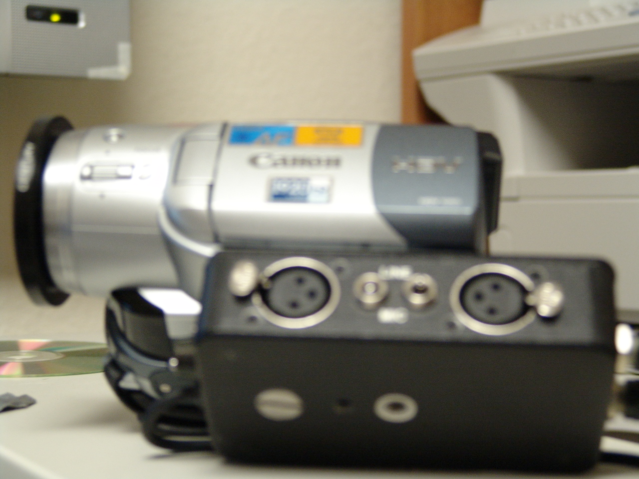

Though I haven't tried it yet, this is what the Beachtech DXA-4 looks like,mounted to the HV20. See photo attached.

Hey, Chris, lookin' good!
Will that setup limit you to handheld, maybe it's the angle, but I don't see how you could put it on a tripod? Either way, I look forward to your comments, I've been enjoying your 'Sony User Tries Canon HV20' thread each step of the way!!

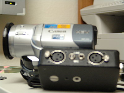

The adapters that are made to bolt on to the bottom of a camera, have a have the same thread underneath that is on your camera. See the picture attached. This week sometime I plan to try the rig with my Sennheiser ME66 attached. Biggest issue I see is the potential for mic, due to length, protruding to far into picture frame...
