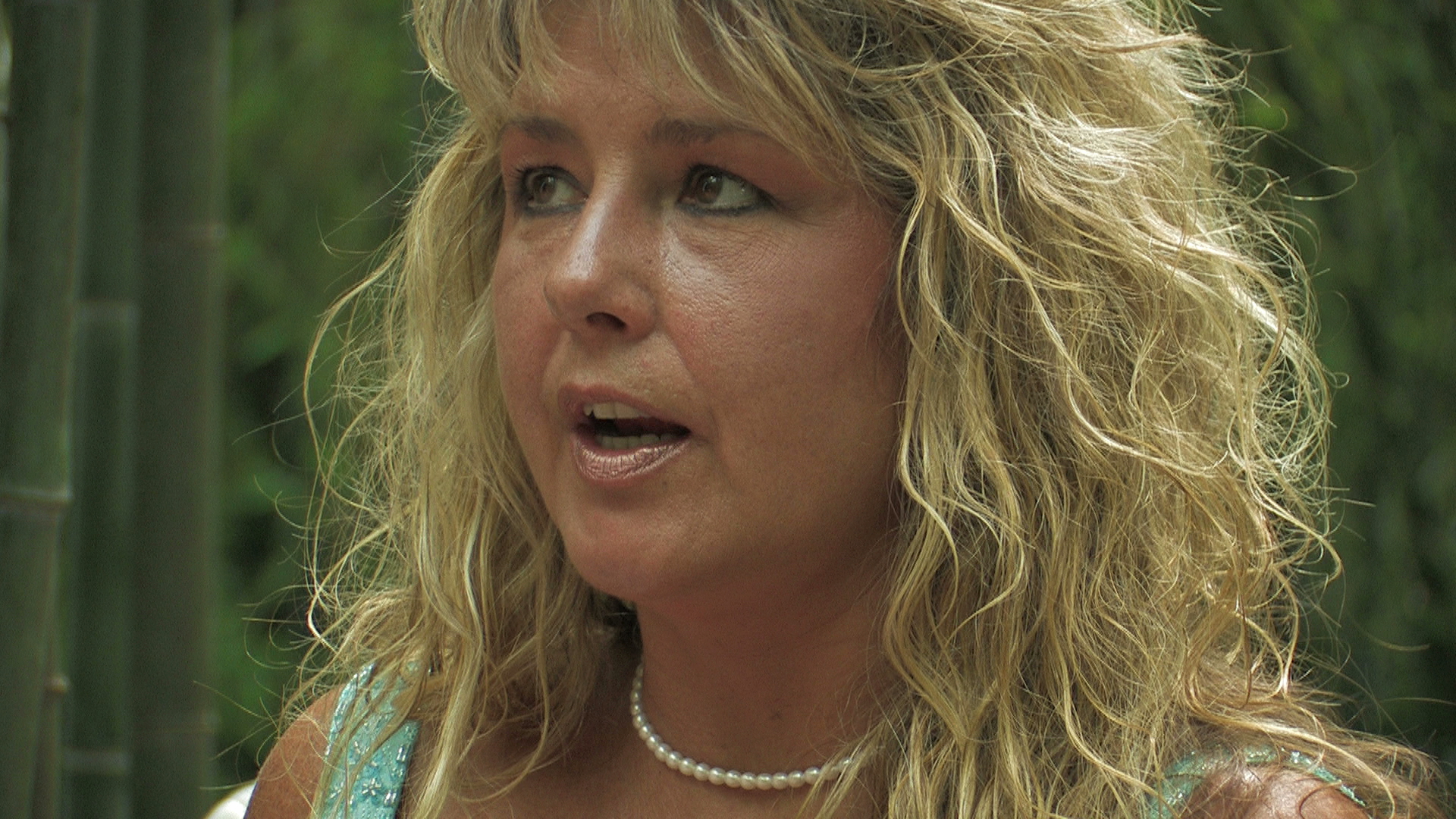

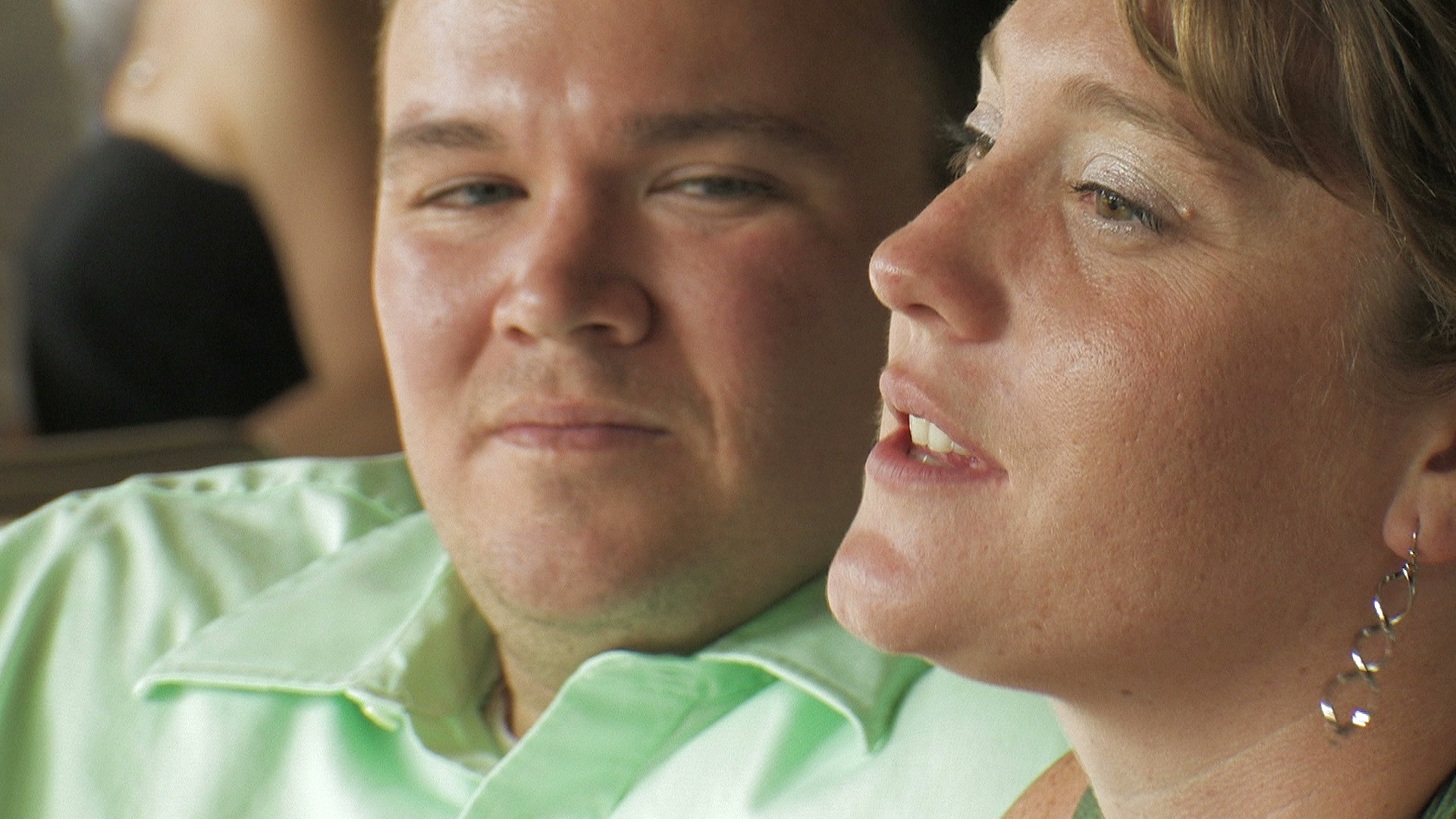

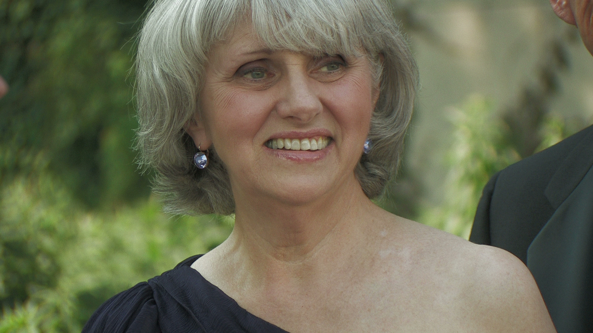

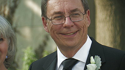

To throw into the mix for comparison, here are some Canon XL H1S/Nanoflash footage still extractions (shot 24F at 50mb 4:2:2, 0db). Sharpness at 0.
Raw samples of Canon XF300 & Sony EX1R-xl763001-1.jpeg   Raw samples of Canon XF300 & Sony EX1R-xl271001.jpeg
Raw samples of Canon XF300 & Sony EX1R-xl271001-1.jpeg   Raw samples of Canon XF300 & Sony EX1R-xl603001.jpeg

interesting. difficult to compare given such different samples - but one thing that I notice right off the bat in the frame grabs is that the XF camera has much less noise than the XL H1S/Nanoflash. It looks like the XF300 at +6db is better than the XL H1S at 0db.
edit - I also see some aliasing in the blonde girl's hair in the XL H1S/Nanoflash grab. I don't notice any in either of the XF300 grabs, but they may not be the best frames to test for that kind of artifact. Alan Roberts does mention in his test report, though, that the XF camera showed no aliasing artifacts at all.
